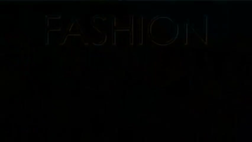

    Originally Posted by JadHC View Post
    Would these work?
    Screenshots not good. Post the video and the time to find those frames.
  7. Originally Posted by VoodooFX View Post
    Would these work?
    in this attached video, it is frame 4453 (mid-video) and last couple frames 16243-16245

  9. Originally Posted by VoodooFX View Post
    Video quality is too bad, like most youtube videos. Even in those black frames image is missing pieces...
    thank you, Voodoo. I will try to do temporal thingy as per pandy's comment and maybe that could enable the removal of watermark.

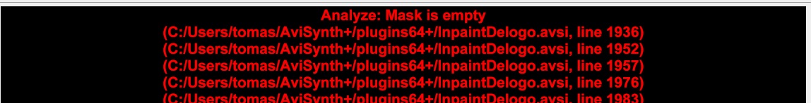

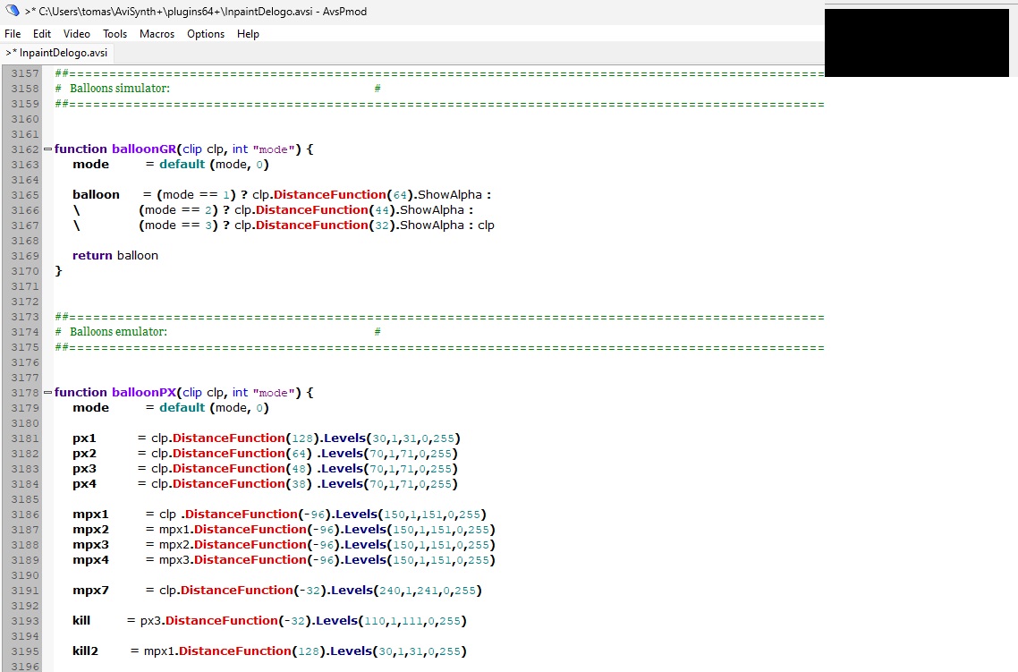

    ...but i get following error that it doesnt recognize DistanceFunction.
    Look at "Core requirements" again.
  11. Originally Posted by VoodooFX View Post
    No, it won't.
    So it's a hopeless case?
    I think i found the issue at the link below.. i installed AvsInPaint.dll and now working on debugging the mask... Is this looking better?
    http://forum.doom9.net/showthread.php?p=1893934

  12. Originally Posted by VoodooFX View Post
    oh my, face palm... yes indeed, Core requirements do list AvsInPaint... duh... I need to have my morning coffee... thanks for spotting this...
