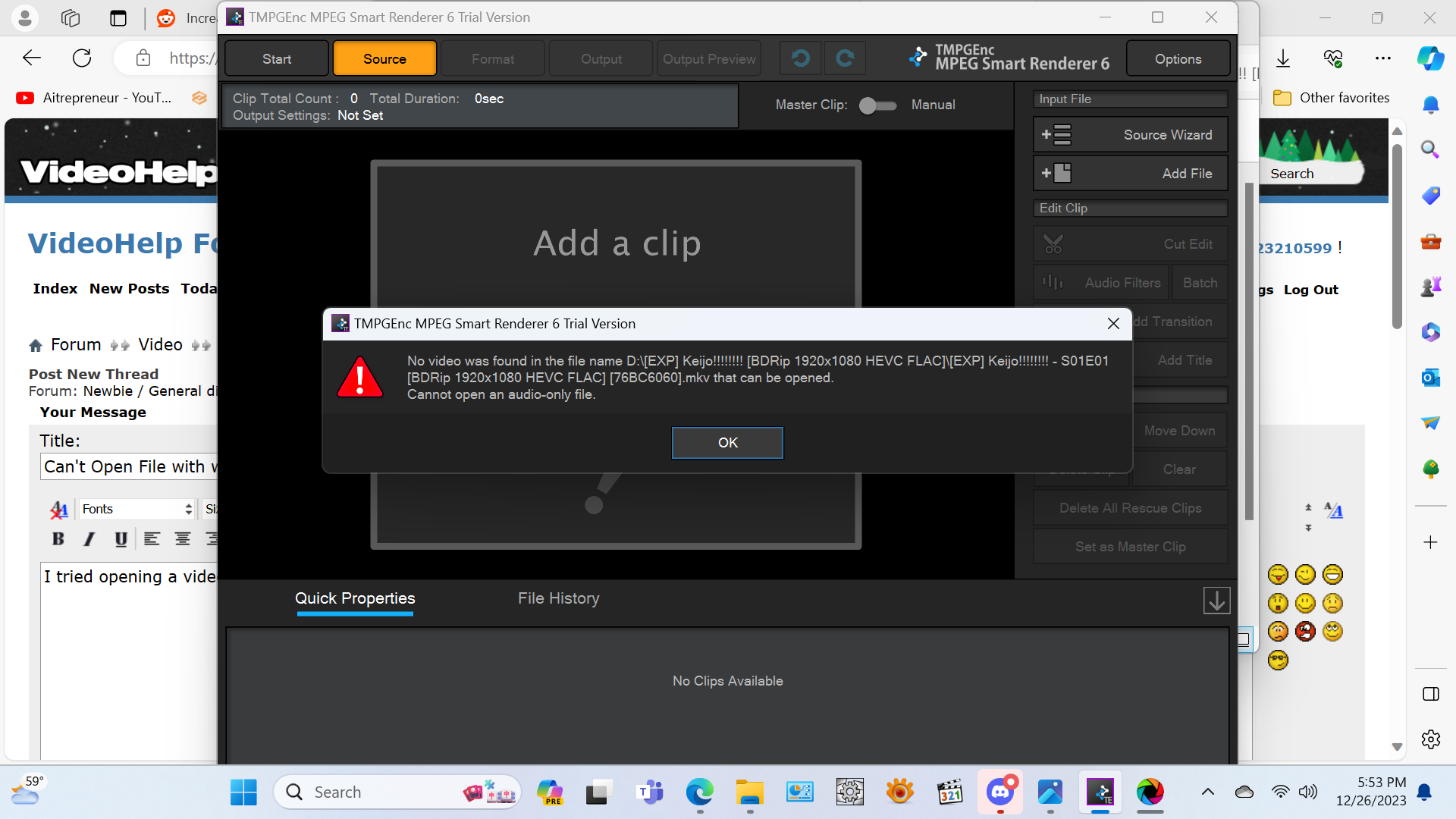

    I tried opening a video file with TMPGEnc MPEG Smart Renderer 6, but I got this error message. Can someone help me?

  3. Your video - 10bit444 HEVC - is not supported
    https://tmpgenc.pegasys-inc.com/en/product/tmsr6_spec.html
    * H.265/HEVC in up to 10-bit YUV 4:2:2 format only.

    If you are only cutting short clips - chances are it's only 1 GOP and would be re-encoded anyways. Smart rendering only makes sense for longer segments with more than 1 GOP

    This won't work for that video. That person re-encoded the original source with 10bit444 for whatever reason . Or use the original, original BD source
    Just mark in/ mark out - edit it in a normal editor like avidemux and re-encode it . Since you're re-encoding anyways, smart rendering doesn't matter
