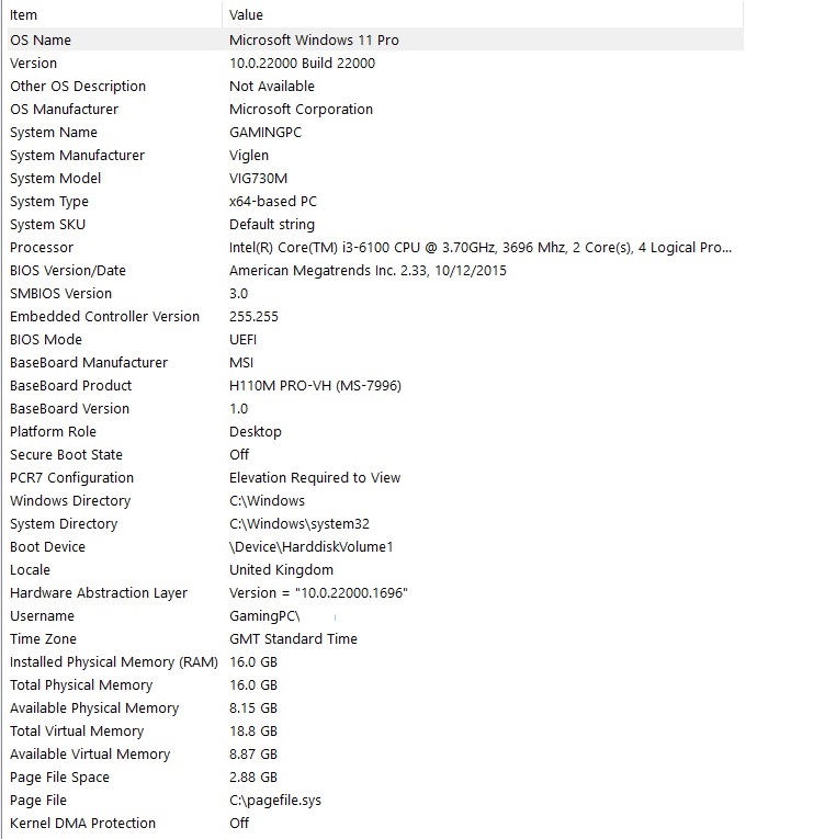

    What are the computer specs?Some gaming units are built just for games in mind and lack processing power for video apps.
  4. Originally Posted by johns0 View Post
    Hope this helps:
    [Attachment 75808 - Click to enlarge]

    My understanding: If you don't have an enabled GPU, encoding is done solely by the CPU; the amount of RAM will make little difference. Where RAM is good is when you're editing and more of the info eg video and audio data the editor uses can be loaded into (the much faster) RAM instead of onto a hard drive. So, the more RAM the better for editing.
    If you have a GPU, you can choose to use it via the Handbrake video options eg NVenc.
    An i3 isn't a rocket machine; I suspect the CPU your new laptop is probably similar, explaining the similar encoding times.

    The specs for your son's new gaming PC from your other thread about it:
    Processor: Intel Core 6100
    Memory: 16GB DDR4
    Storage: 1TB SSD
    Graphics: NVIDIA GTX 1650
    The Intel Core i3-6100 processor's Intel 530 HD graphics can encode and decode H.265. An NVIDIA GTX 1650 is also supposed to be able to encode and decode H.265, so it should work.
