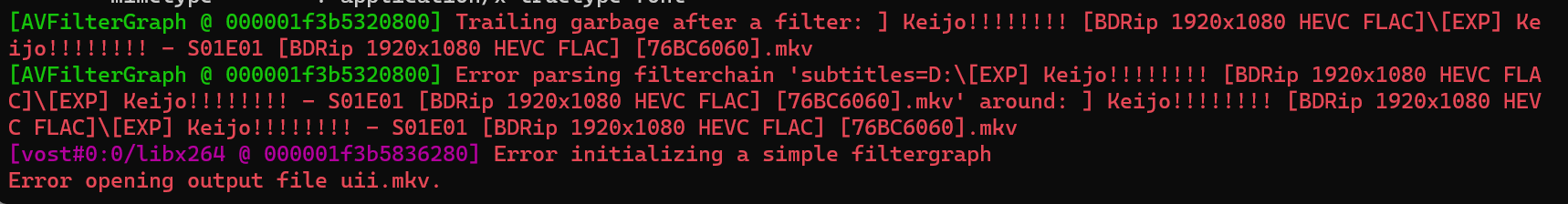

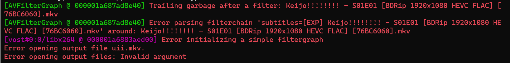

  1. I tried burning in the subtitles embedded in the video using ffmpeg but I got this error.
    [Attachment 75757 - Click to enlarge]
    [Attachment 75758 - Click to enlarge]
    I also tried extracting the subtitles and using that but I got the same error. Can someone help?

  2. post your complete command line, not just the error

  4. Okay, that did not answer the question I posted at all.
    Since it is Christmas:
    I suspect the problem is with your call, and you lack quotes, ticks and or escaping at the right places in the command line.
    Using the subtitle file you provided, I have no problem embedding these subtitles into the image of a video.
    Using for example:
    ffmpeg.exe -i "g:\TestClips&Co\files\5000frames.mp4" -vf subtitles='c\:\\Users\\Selur\\Desktop\\kk.srt' "g:\Output\test.mp4"
    works fine.
    With this you should be able to understand how you would need to add quotes, ticks and escape stuff with your paths etc. to get your call working.
    Merry Christmas.
    Cu Selur
