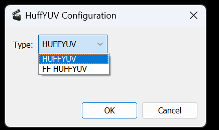

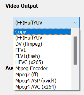

    I would convert to lossless in Avidemux (probably Huffy) and use that as your source. Then it's frame accurate
    You mean this?
    [Attachment 75733 - Click to enlarge]
    [Attachment 75734 - Click to enlarge]
    Mar 2008
    Either of those
