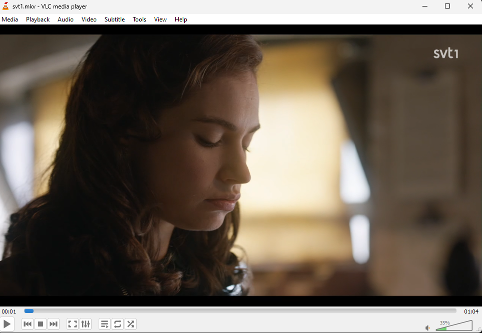

    Use N_m3u8DL-RE.
    N_m3u8DL-RE.exe "https://svt-secure-d.akamaized.net/secure/svt1/master-fmp4.m3u8?defaultSubLang=sv" --custom-hls-key 95bbffecef552b1f889b6fec5468fe59 --live-real-time-merge --live-record-limit <TIME>
    And then replace <TIME> with your willing recording time e.g. 01:00:00

  13. You're making things a little more difficult than they need to be.
    Each live channel on SVT Play has its own DASH manifest, and they're seemingly static. There's no token or signature. So once you have it, you have it. No need to extract it every single time:
    SVT1: https://svt1-d.akamaized.net/se/svt1/manifest.mpd?defaultSubLang=1
    SVT2: https://svt2-d.akamaized.net/se/svt2/manifest.mpd?defaultSubLang=1
    SVT Barn: https://svtb-d.akamaized.net/se/svtb/manifest.mpd?defaultSubLang=1
    N_m3u8DL-RE not only comes with live "recording" capabilities, but you can also set it to start at a specific time. So it literally does everything you're asking for.
    This will give you a recording of ~1 minute that starts at 2023-12-28 22:15:
    N_m3u8DL-RE "https://svt1-d.akamaized.net/se/svt1/manifest.mpd?defaultSubLang=1" --save-name svt1 --auto-select -M format=mkv:muxer=mkvmerge --live-real-time-merge --live-record-limit 00:01:00 --task-start-at "20231228221500"
    [Attachment 75828 - Click to enlarge]
    Feb 2021
    OK, I tested your command after modifying the start time.
    The execution ran in steps and printed output at intervals of maybe 10 seconds.
    At the end there were these messages:
    $ N_m3u8DL-RE "https://svt1-d.akamaized.net/se/svt1/manifest.mpd?defaultSubLang=1" --save-name svt1 --auto-select -M format=mkv:muxer=mkvmerge --live-real-time-merge --live-record-limit 00:01:00 --task-start-at "20231228231300"
    23:12:47.461 INFO : N_m3u8DL-RE (Beta version) 20230628
    23:12:47.476 INFO : The program will wait until: 12/28/2023 11:13:00 PM
    23:13:00.478 INFO : Loading URL: https://svt1-d.akamaized.net/se/svt1/manifest.mpd?defaultSubLang=1
    23:13:00.604 INFO : Content Matched: Dynamic Adaptive Streaming over HTTP
    23:13:00.604 INFO : Parsing streams...
    23:13:00.609 WARN : Writing meta json
    23:13:00.610 INFO : Extracted, there are 9 streams, with 6 basic streams, 2 audio streams, 1 subtitle streams
    23:13:00.610 INFO : Vid 1280x720 | 5943 Kbps | v4 | avc1.640020 | 10 Segments | ~00m31s

  15. Originally Posted by BosseB View Post
    So why did the downloader not combine the video and audio when creating the final mp4???
    The muxing probably fails because of the ttml subtitles. Add "-ds all" to drop them and see if it works.
    The N_m3u8DL-RE --help section is in English, so be sure to check that out as well.

    I figured out how to use streamlink to retrieve the videos using the URL's shown above in this thread:
    The final solution in my other thread.
    FOLLOW-UP QUESTION:
    How do I get the akamaized url for Kunskapskanalen and SVT24?
    https://www.svtplay.se/kanaler/kunskapskanalen?start=auto
    https://www.svtplay.se/kanaler/svt24?start=auto
    It seems like the 3 url's shown above differ only by the abbreviations svt1, svt2 and svtb.
    What is the abbreviation for SVT Kunskapskanalen and SVT24??
  21. Kunskapskanalen:
    https://svtk-c.akamaized.net/se/svtk/manifest.mpd?defaultSubLang=1
    SVT24:
    https://svtb-c.akamaized.net/se/svtb/manifest.mpd?defaultSubLang=1
  22. Member
    Feb 2021
    Originally Posted by stabbedbybrick View Post
    Kunskapskanalen:
    SVT24:
    Thanks a lot!
    I have now included these URL's in my script and tested them and they work just fine like the three you posted before.
    How did you find them? I tried by using curl and grep but I got no hit...
