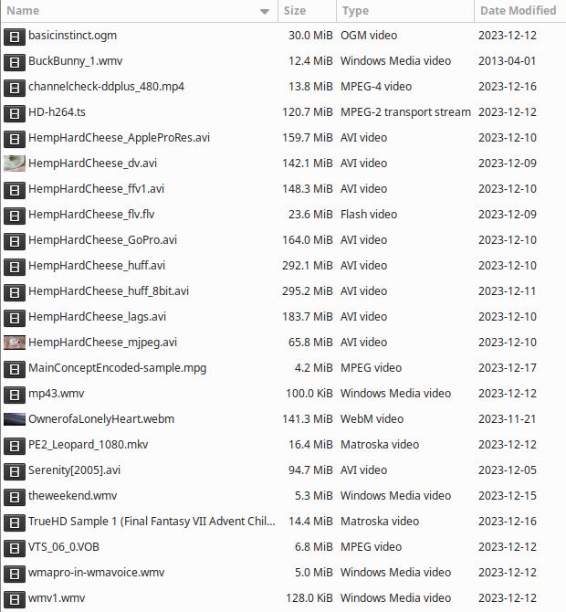

    Here is a Test folder before processing:
    [Attachment 75737 - Click to enlarge]

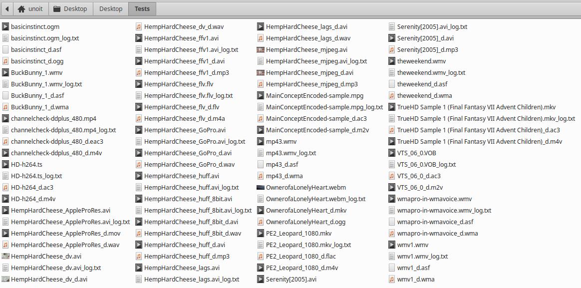

    Here is the Test folder after using the script:
    [Attachment 75738 - Click to enlarge]
    if one uses Open With instead of Send To there won't be any terminal output - but there will be the individual log files
    and here is the terminal output when using Send To ffprobefolder:
    video file to demux: basicinstinct.ogm
    demuxed video file: basicinstinct.asf
    demuxed audio file: basicinstinct.ogg

    video file to demux: PE2_Leopard_1080.mkv
    demuxed video file: PE2_Leopard_1080.m4v
    demuxed audio file: PE2_Leopard_1080.flac
    video file to demux: Serenity[2005].avi
    demuxed video file: Serenity[2005].avi
    demuxed audio file: Serenity[2005].mp3
    video file to demux: theweekend.wmv
    demuxed video file: theweekend.asf
    demuxed audio file: theweekend.wma
    video file to demux: TrueHD Sample 1 (Final Fantasy VII Advent Children).mkv
    demuxed video file: TrueHD Sample 1 (Final Fantasy VII Advent Children).m4v
    demuxed audio file: TrueHD Sample 1 (Final Fantasy VII Advent Children).ac3
    video file to demux: VTS_06_0.VOB
    demuxed video file: VTS_06_0.m2v
    demuxed audio file: VTS_06_0.ac3
    video file to demux: wmapro-in-wmavoice.wmv
    demuxed video file: wmapro-in-wmavoice.asf
    demuxed audio file: wmapro-in-wmavoice.wma
    video file to demux: wmv1.wmv
    demuxed video file: wmv1.asf
    demuxed audio file: wmv1.wma

    This Windows batch file will demux media files into video and audio files
    It can handle over 20 different audio codecs and over 26 different video codecs
    ffmpeg.exe and ffprobe.exe are required
    The default location for these two files is c:\ffmpeg\bin - just edit the batch file [in any text editor] to change to your location
    It is best to use a folder that just contains media files that have audio and video.
    To use just drag and drop any media file from the folder to demux_folder.bat
    The demuxed files will go into demux folder and the log files will go into logs folder
