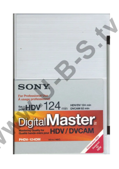

    So what I was trying to describe was having shot on the Sony Z1 with a tape similar to this Image
    [Attachment 75732 - Click to enlarge]
    I was able to use the z1 to digitise to PC in raw, uncompressed format which was mpeg 2 I think- and about 10gig for 60mins- so a really high quality source. I think your sample had restored that original, uncompressed footage- from what I could tell. Those original rushes files were 1440 x 1080. I saw somewhere max YouTube upload is 120 gig which I have space to host and then download and upload to yt
