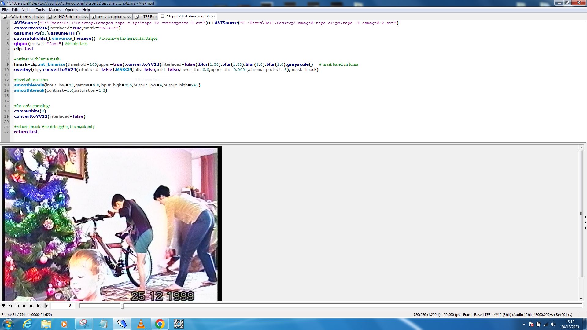

    Thanks Sharc. I will look at that link. I wasn't able to get Gaussianblur() working so I took Sharc's advice and used Blur() 4 times. I'm not sure what the best values are, changing them didn't seem to alter much. I have read chain negatives values can cause problems so I avoided this, although minus values didn't encroach as badly on the bottom brown bar.
    I haven't used a denoiser, I struggled to find a denoiser compatible with the YV16 planer. I was hoping someone may have the MCDegrainSharp() script.
    I'm guessing line 16 can be removed it's only for showing the two clips side by side? Thanks.
Name:	Sharc script Line 16 StackHorizontal.JPG
Name:	Sharc script minus Line 13 StackHorizontal.JPG
  4. The Retinex is for experimenting. You would actually have to evaluate its effect on the entiere clip including varyous scenes with various exposures. Maybe at the end you skip it alltogether and be done with the levels adjustments tweaks (lines 13, 14).

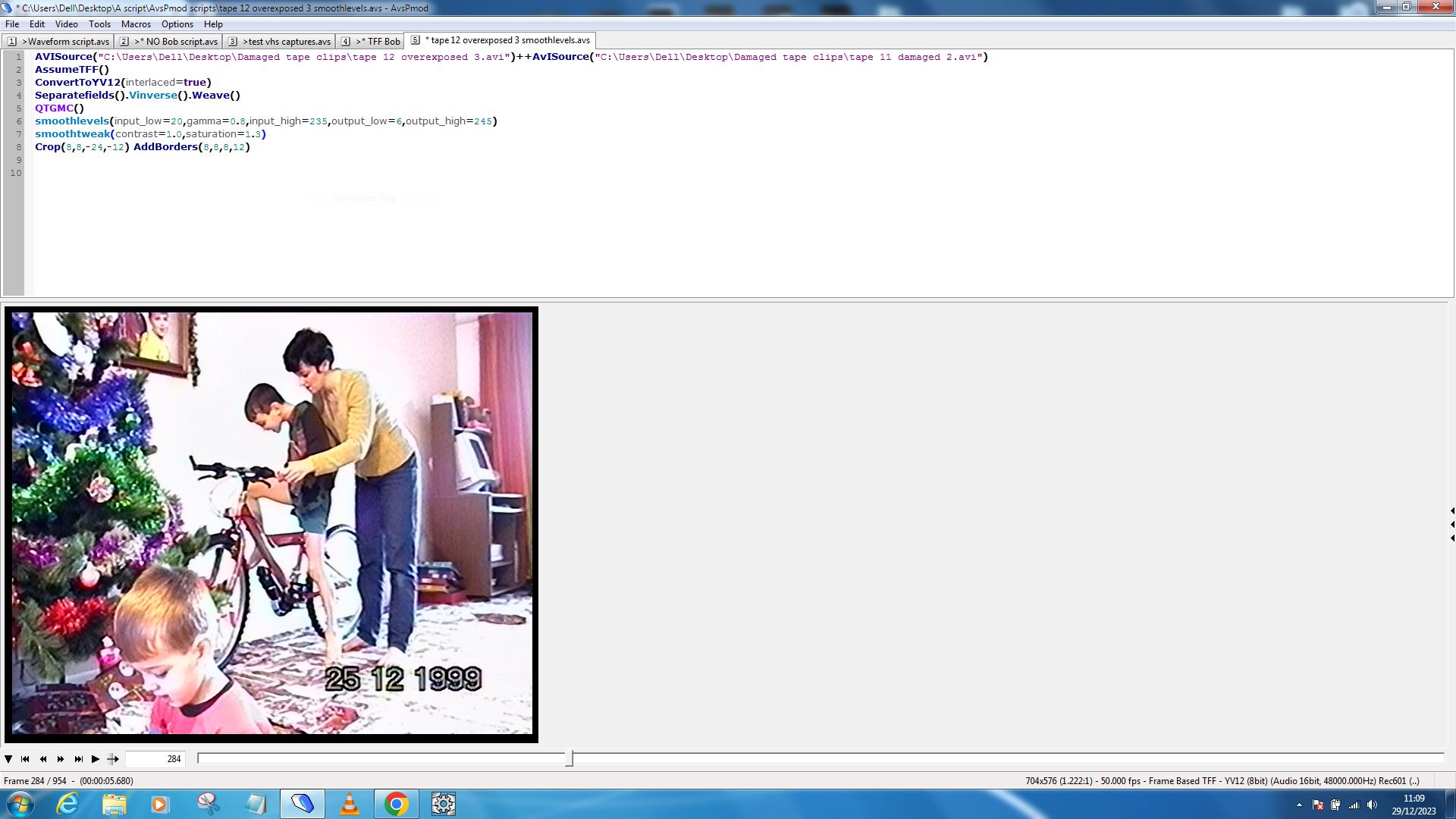

    Thanks Selur. I tried what Sharc mentioned in post#21 using smoothlevels which does seem to improve it overall. I know I've got to be realistic and I'm probably not going to get much more improvement than this Thanks Sharc, I should have listened earlier!
Name:	Tape 12 & Tape 11 script smoothlevels.JPG

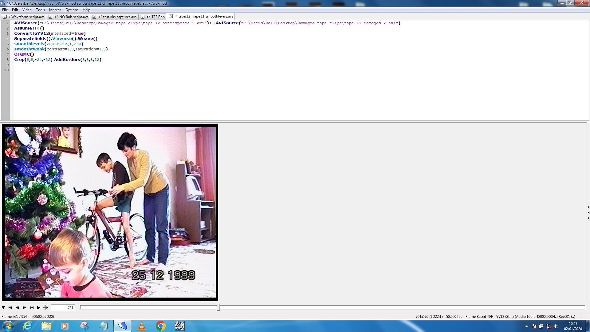

    I'm still learning about Smoothlevels() Is it better if you use this before QTGMC() in the scipt? Thanks.
Name:	Smoothlevels before QTGMC in script.JPG
  12. Your eyes decide - if you see a difference at all.
    Sep 2021
    Thanks Sharc. They look the same to me on my monitor. I will take a look on my TV. I thought I read somewhere that you should do any color work before QTGMC() but I'm probably gettting confused with something else. Thanks.
    Sep 2021
    I've just watched both on my TV and I couldn't see any difference. I just wasn't sure if there is a preferred order when deinterlacing videos? Thanks.
