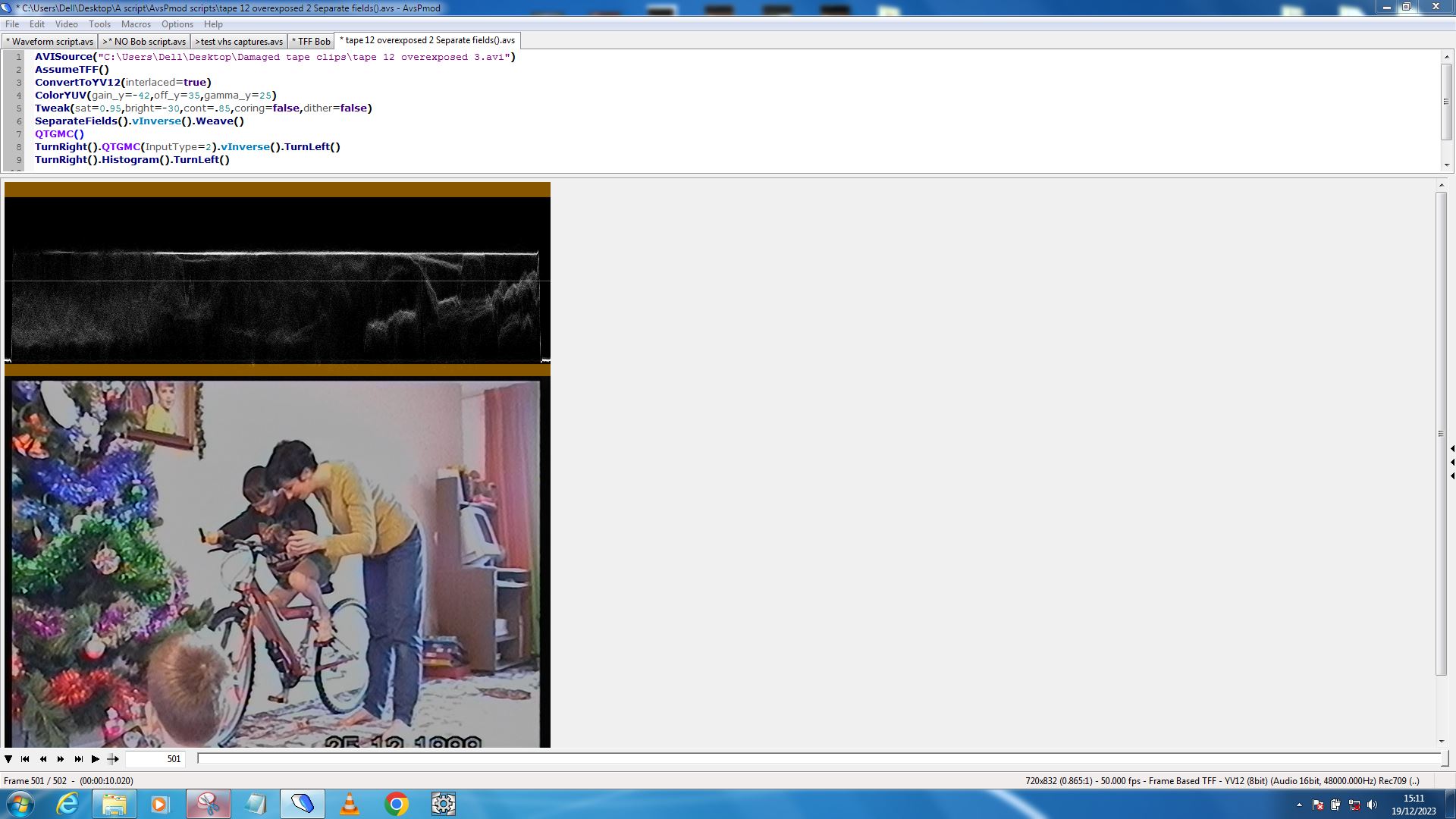

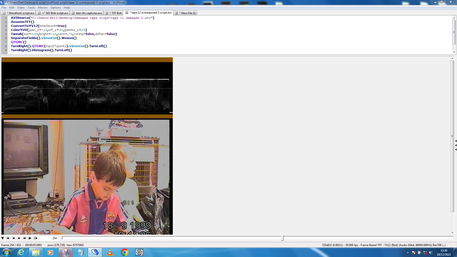

    I have a couple of tapes that have some overexposed footage. I know any improvements I make will be small however, I would still like to try. I'm hoping to reduce the high contrast lines and reduce the brightness, anything else would be a bonus. I know there is very little detail to work with.
    Sorry in advance for my crude scripts, I don't really know the best way to achieve the improvements. The SeparateFields().vInverse().Weave() seems to work well with the high contrast lines, jagabo used this in a previous script.
    I wasn't sure of the best way to reduce the brightness of the pixels with ColorYUV() and Tweak() Any advice would be grateful.
Name:	Tape 11 damaged 2 script.JPG
Name:	Tape 12 overexposed 3 script.JPG

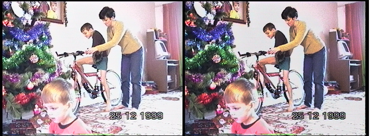

  11. So here an attempt with Retinex. The brights are 'stretched' somewhat, see the waveforms. A little improvement perhaps .... (?)
    https://github.com/Asd-g/AviSynth-Retinex

  15. Originally Posted by SkyBlues2021 View Post
    .... the Retinex video again an upgrade a definate improvement on what I have. I will watch it on my TV, it helps to be able to see both videos side by side and it looks better and less bright....
    Your TV might refuse to play this side-by-side format. So here 2 rescaled variants which your TV should play:

  24. Originally Posted by johnmeyer View Post
    I got a little better result using the old Vegas over-brightening trick of inverting, then adjusting gamma upwards, and the inverting again. However, I didn't think it was enough of an improvement to post when I first looked at this, but since others have posted, I've shown a frame below.
    John: Nice trick. In order to remove the horizontal stripes (e.g. on the boy's red shirt) I used:
    Separatefields().Vinverse().Weave()
    I have observed these horizontal stripes a few times before for PAL home videos. No idea where this comes from. A (SONY?) videocam oddity?
  25. Originally Posted by SkyBlues2021 View Post
    Thanks Sharc. I will use your code and post. I will persevere and try to get gaussianblur to load. I was pleased with the retinex video you did, it was certainly an upgrade on mine. I'm guessing you used gaussianblur in the code for your Retinex for TV video?
    Yes. Here the full script (I hope I remember correctly, a lot of parameters to play with):
    AVISource("tape 12 overexposed 3.avi")
    converttoYV16(interlaced=true,matrix="Rec601")
    assumeFPS(25).assumeTFF()
    separatefields().vinverse().weave()  #to remove the horizontal stripes
    qtgmc(preset="fast") #deinterlace
    clip=last
    MCDegrainSharp()  #for denoising, or use your preferred denoiser
    #retinex with luma mask:
    lmask=clip.mt_binarize(threshold=100,upper=true).converttoYV12(interlaced=false).GaussianBlur(varY=2000.0).grayscale()    # mask based on luma
    overlay(clip, converttoYV24(interlaced=false).MSRCP(fulls=false,fulld=false,lower_thr=0.0,upper_thr=0.0001,chroma_protect=3), mask=lmask)
    #level adjustments
    smoothlevels(input_low=20,gamma=0.8,input_high=235,output_low=6,output_high=245)
    smoothtweak(contrast=1.0,saturation=1.3)
    StackHorizontal(clip.turnright().histogram().turnleft().subtitle("  original deinterlaced"), last.turnright().histogram().turnleft().subtitle("  retinex with mask"))
    #for x264 encoding:
    convertbits(8)
    #return lmask  #for debugging the mask only
    return last
