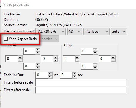

    Originally Posted by Sharc
    In DVDStyler you can set the DAR 4:3, crop to 704(x576) and encode as 704(x576), and it uses the correct PAR for the DVD. Am I missing something?
    I suspect so. Cropping does not fix the lack of PAR in the 0riginal file. One has to untick "Keep aspect ratio" in DVDStyler. It will then stretch the video out to fill the frame. Perhaps your script somehow inserts a PAR/DAR/SAR that DVDStyler uses to correctly interpret the 4:3.
    For a simple insertion of the original ULY2 file, you have to untick Keep Aspect Ratio.
    [Attachment 75884 - Click to enlarge]

  3. Originally Posted by Alwyn View Post
    Of course you have to untick the "Keep Aspect Ratio". Otherwise you can't even crop manually in DVDStyler.
    The GUI authors have to decide on what to put as default settings. It may be 50% right and 50% wrong of the use cases, depending on the source and target format. Even when using nice GUIs one has to know what one is doing, but as things happen under the hood one has sometimes to 'experiment' to understand the effect of the buttons, dropdown menus and tick boxes.
    Ferraris capture is 720x576, interlaced, according to Rec601, as it shoud be. So it has small bars left and right, and DVDStyler does not have to "fix" anything. All you have to remember for Rec601 compliant (as it should be, unless the capture infrastructure or drivers are crap) analog captures is to cut 16 pixels in total off the sides, select the frame size to 704x576 in DVDStyler (which is DVD spec compliant), encode accordingly as 4:3 DAR. Now you can relax and flush all the worries whether 4:3 is 1.33 or 1.36, 2% AR error or not, any PAR signalling on or off, make a detour via square pixels etc. All within 1 or 2 pixels accuracy (as the "true" width of a Rec.601 PAL capture is about 702 pixels rather than 704).
    No. DVD doesn't even specify the PAR explicitly. It just knows 3:4 or 16:9 DAR. The PAR follows implicitly from the cropping and 704x576 4:3 encoding as explained above.

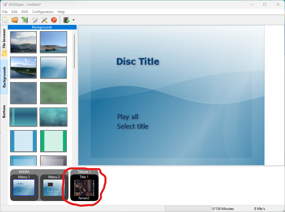

  4. Member DB83's Avatar
    Jul 2007
    Methinks we are all working to a common goal - to provide the OP with an acceptable dvd. The lack of feedback could well be down to the holdidays (or being blinded by 'science')
    Whilst the general consenus is to use avisynth, this is a path that the OP, like many others, may not wish to go down. Even so, it could be useful if a little tutorage as to how a script can be fed into DVDStyler would not go amiss - for the life of me I could not see that option. And I originally chose avstodvd since I thought it a more simple program - shame about the chroma fault (even if it is generally un-noticable at normal playback)
    But just to add to the DVDStyler debate, I have, and this time I do promise, created a basic dvd. I left bitrate at the max. With my poor eyes I do not know if that chroma issue is still there.
  5. Originally Posted by DB83 View Post
    Drag and drop the .avs onto the assets area of DVDStyler. Wait a few seconds to let DVDStyler import it. Could it be any simpler?
    And there is a Help and documentation in the home page. GUI lovers seem to expect a button for eveything
    (Again: I am not defending or bashing any tool here )
