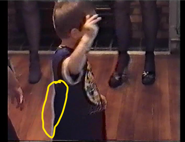

    And once we are at it:
    Go to frame 41 and watch the back of the boy when you step through the video (right panel = bobbed picture in Vdub).
    Do you see the white (decolored) line coming and going? This is the Chroma flaw I have been mentioning. The chroma does not advance synchronously with the luma at the fieldrate, but only at the framrate. May be the encoder, may be the settings, maybe the generated script, maybe the GUI ..... you name the culprit

    Go to frame 41
    That flaw's on your VOB, not on the original, @Sharc.

    Of course it's in the VOB. Did I say anything else? Btw. it's the VOB of DB83's encodes in his post #66 where he was asking for comments.
    Ferrari's capture is ok, so it should just be processed and encoded correctly rather than being butchered by all means (base rate deinterlacing or interlaced with wrong field order flagging, inadequate noise filtering, faulty YV12 interlaced chroma processing, too low bitrate .....)
