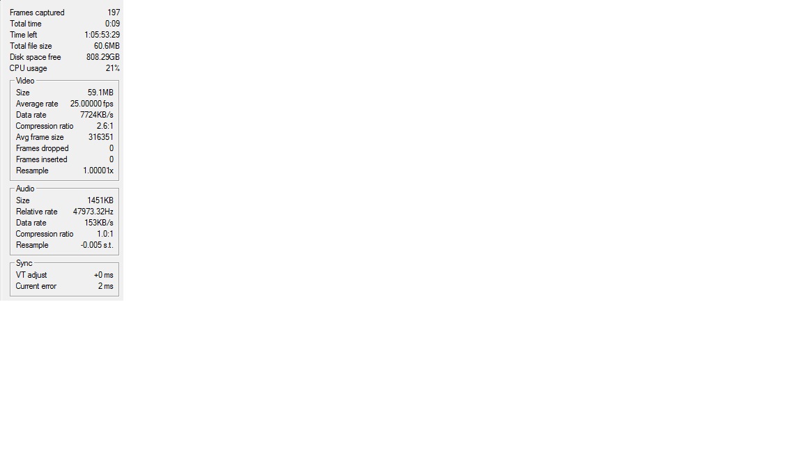

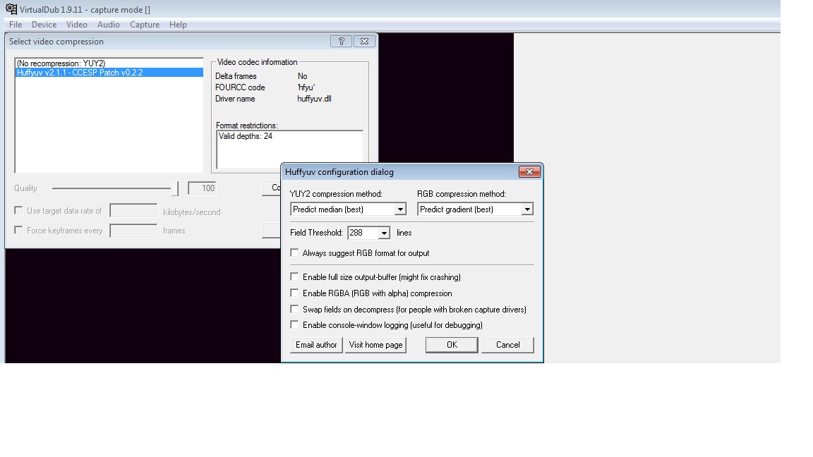

    I am new to VHS capturing and I own a Happauge USB Live 2.0 because I read you can capture lossless with this capture card and it is a good budget option.
    I am capturing Pal-B format Vhs and my current workflow is the following:
    Blaupunkt RTV 966 with svhs cable conneted to Panasonic DMR-EH575 ad passthrough for tbcish function conneted via svhs to my happauge live 2.0.
    I tried capturing with huffyuv activated in vdub VirtualDub 1.9.11 but I always get compression ratio 2.6:1 which is not really lossless and I am confused why that might be the case. (see picture)

    yes but why is my video compressing if I use huffyuv?
    is there something wrong with the configuration perhaps?
    If I use the built in uncompressed codec I get no compression

    Nothing wrong with your settings.
    Our 'friend' is not helpful inasmuch that huffyuv DOES compress as opposed to a fully uncompressed (no codec used) capture. Lossless refers to the retention of information when you edit/resave that capture using the same codec whereas a lossy codec such as mpeg2 or DV will lose information.

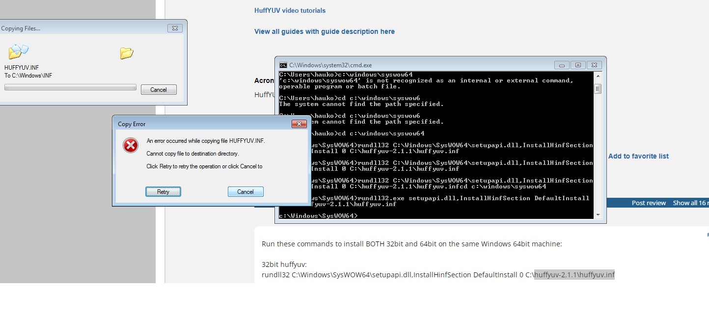

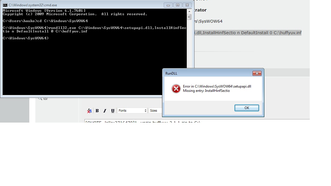

    I can't seem to manage to install the version from this website I always get the following error maybe because I got the other version installed?
    I am using windows 7 64 bit
  12. Captures & Restoration lollo's Avatar
    Jul 2018
    Italy
    1- unzip huffyuv-2.1.1.zip to C:\
    2- Copy huffyuv.dll and huffyuv.inf in C:\Windows\SysWOW64
    3- Open up a command prompt (DOS box) as administrator
    4- In the command prompt (DOS box) go to C:\Windows\SysWOW64
    5- Type: rundll32.exe C:\Windows\SysWOW64\setupapi.dll,InstallHinfSectio n DefaultInstall 0 C:\huffyuv.inf
  13. Originally Posted by lollo View Post
    I still get following errorImage
    [Attachment 75626 - Click to enlarge]
  14. Member DB83's Avatar
    Jul 2007
    Then 'safest' approach is to formally uninstall ALL instances of the huffyuv codec >> if your OS is like mine you go to Programs & Features from Control Panel. Scroll down to huffyuv > right-click uninstall/remove.
    Then install the approved version following the instructions as displayed from the zip.
  15. Originally Posted by DB83 View Post
    think I managed I unzipped the filder in syswow64 and just right click installed thanks a lot guys will start capturing now see you soon when I have no idea how what to do with the raw files

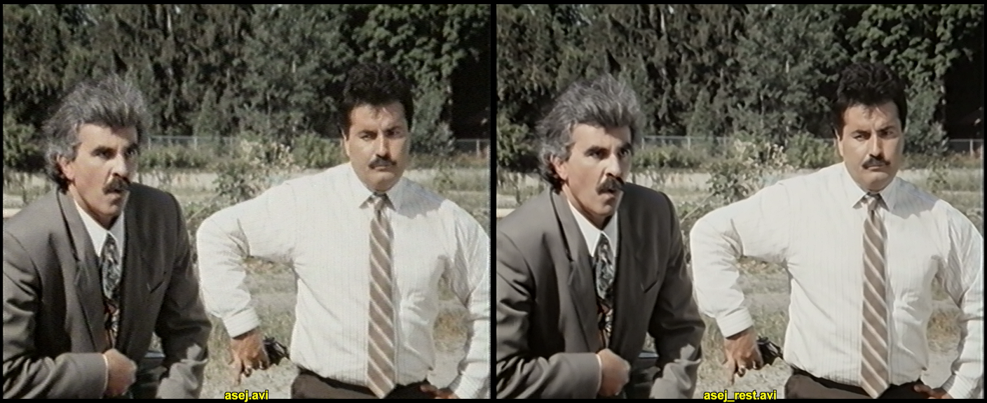

  26. Captures & Restoration lollo's Avatar
    Jul 2018
    Italy

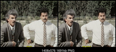

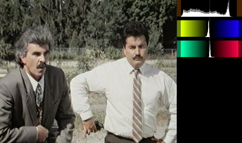

    Your capture is nice. As Sharc already said, the source is "progressive", meaning the 2 fields are coming from the same moment in time, and the levels are well centered:
    no need for deep restoration, a simple denoise+sharpen is enough:
    video_org=FFmpegSource2("asej.avi", atrack=-1)
    # trimming
    	trim_start=360
    	trim_end=738
    video_org_trim=video_org.trim(trim_start,trim_end)
    # cropping
    	crop_left=14	# | rimozione esatta delle bande nere sinistra, sopra, destra e del disturbo sotto
    	crop_top=4	# | 720-(14+10)x576-(4+8)=696x564
    	crop_right=10
    	crop_bottom=8
    video_org_trim_crop=video_org_trim.crop(crop_left,crop_top,-crop_right,-crop_bottom,align=true)
    ### convert to YV16
    video_org_trim_crop_yv16=video_org_trim_crop.convertToYV16()
    ### denoising
    denoised_yv16=video_org_trim_crop_yv16.TemporalDegrain2(degrainTR=3)
    ### convert to YUY2
    denoised=denoised_yv16.convertToYUY2()
    ### convert to YV12
    denoised_yv12=denoised.convertToYV12()
    ### sharpening
    sharpened_yv12=denoised_yv12.LSFmod(defaults="slow")
    ### convert to YUY2 with chroma from YUY2 color space
    sharpened=sharpened_yv12.convertToYUY2().MergeChroma(denoised)
    ### add borders
    sharpened_borders=sharpened.addborders((crop_left+crop_right)/2-8,(crop_top+crop_bottom)/2,(crop_left+crop_right)/2-8,(crop_top+crop_bottom)/2)
    return(sharpened_borders)
    Final result: asej_rest.avi
    Comparison side by side
    Comparison with slider: https://imgsli.com/MjI3NTg1

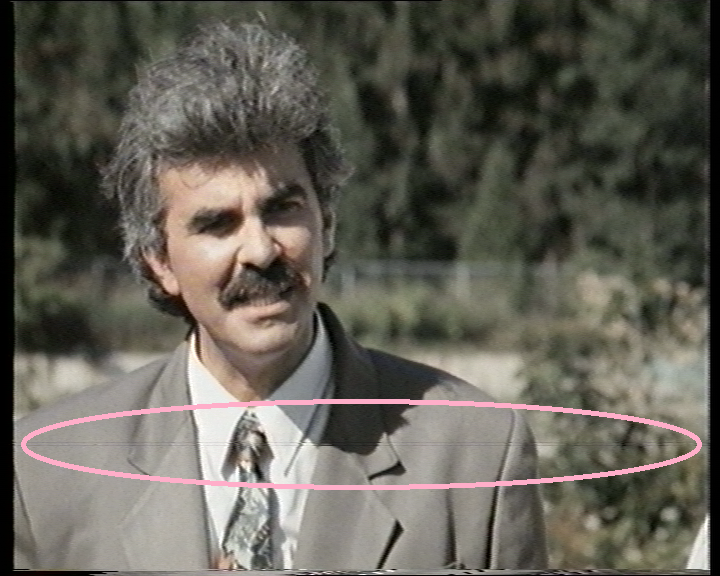

    Maybe some bad frames like 336 showing line errors can be replaced with interpolated frames .
    [Attachment 75638 - Click to enlarge]
    Last edited by lollo; 20th Dec 2023 at 17:13. Reason: uploaded correct restored video file (was original capture earlier:()
