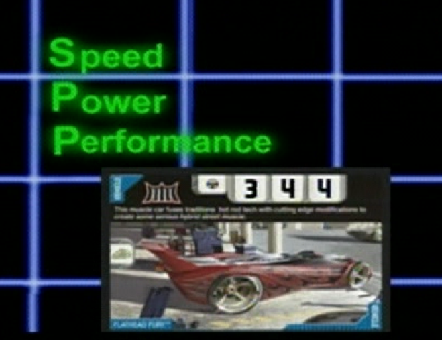

thanks, that seems to have done it. I am noticing some dot crawl/grid pattern though. Any remedy for this?
[Attachment 75608 - Click to enlarge] -
Dotcrawl can be hard to remove without damaging the picture. Better to avoid it by capturing via S-Video rather than composite.
You may try Avisynth's dotcrawl filters.
Or this one has proven to be quite effective for NTSC sources
http://web.archive.org/web/20180505194328/http:/home.earthlink.net:80/~tacosalad/video/dotcrawl.html -
Thanks, I'll check that filter out.
Tbh, I fear the source is already so low in quality (360p) and contains so many tiny details that are already on the brink of being blurred beyond recognition after IVTC that I may just chalk this one up to being unrecoverable.
