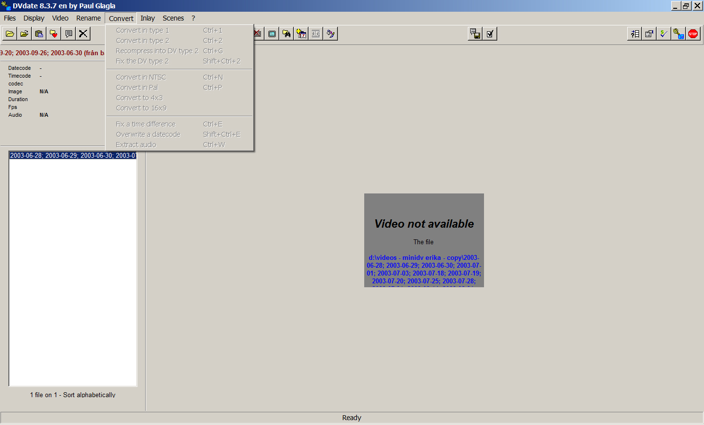

    I followed your instructions, but all options in the Convert menu are greyed out. Also, the software is not displaying any information about the clip.
    Just to see if it's due to the file being corrupt, I tried also with a couple of the previous clips that worked fine in ScenalyzerLive, and it does the same thing with those as well.
    Attaching an example of how it looks. What am I doing wrong?

    Everything in the Convert menu is greyed out in version 7.1.1 as well, except for "Recompress into DV type 2" that is clickable.
    However, I figured out what was causing the software to not work for this particular file: the file name was too long (217 characters). lol
    It was that simple. Now it works, including in ScenalyzerLive.
