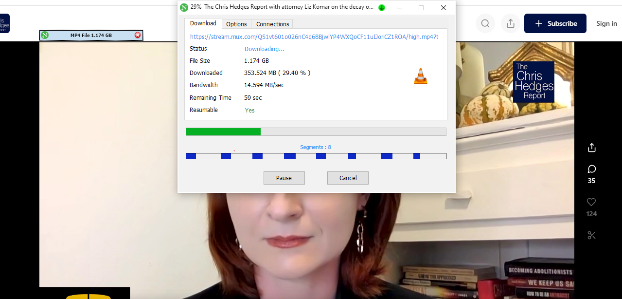

    They present a video and my video downloader addon (I suppose) puts a yellow bar under it saying 'download video' but all it does is cause the video to play in a new window.
    And doing a right click and 'save video' there just saves a json file. Which I can find no use for.
    But the URL I get from that new stream is different. It is like this:
    https://stream.mux.com/QS1vt601o026nC4q68BjwlYP4WXQoCF11uIJoriCZ1ROA/high.mp4?token= ... Etc. Massive long string now.
    So it looks like it is a stream from 'mux.com'
    I can't find any clues on how to save them. Not that I can get to work, anyway. I would like to save it because I want the text, is the thing.

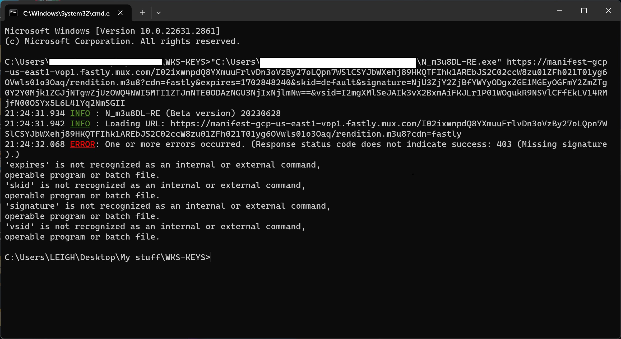

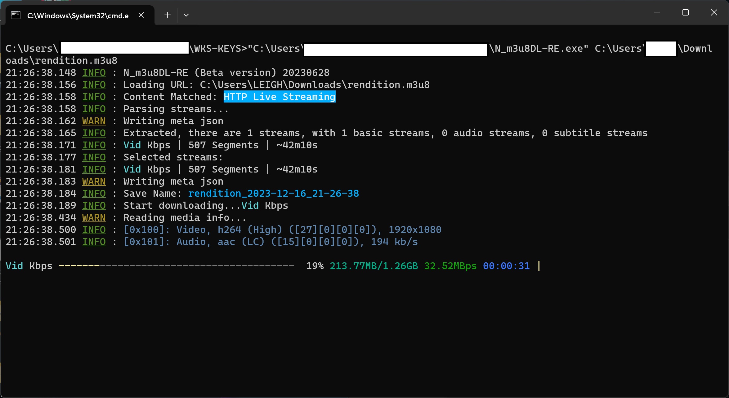

    N_m3u8DL-RE work fine with download m3u8, not direct m3u8 link
    C:\Users\admins>"N_m3u8DL-RE.exe" C:\Users\admins\Downloads\rendition.m3u8
    20:31:24.957 INFO : N_m3u8DL-RE (Beta version) 20230628
    20:31:24.967 INFO : Loading URL: C:\Users\admins\Downloads\rendition.m3u8
    20:31:24.973 INFO : Content Matched: HTTP Live Streaming
    20:31:24.974 INFO : Parsing streams...
    20:31:24.978 WARN : Writing meta json
    20:31:24.981 INFO : Extracted, there are 1 streams, with 1 basic streams, 0 audio streams, 0 subtitle streams
    20:31:24.982 INFO : Vid Kbps | 507 Segments | ~42m10s
    20:31:24.984 INFO : Selected streams:
    20:31:24.985 INFO : Vid Kbps | 507 Segments | ~42m10s
    20:31:24.985 WARN : Writing meta json
    20:31:24.986 INFO : Save Name: rendition_2023-12-16_20-31-24
    20:31:24.992 INFO : Start downloading...Vid Kbps
    20:31:25.463 WARN : Reading media info...
    20:31:25.528 INFO : [0x100]: Video, h264 (High) ([27][0][0][0]), 1920x1080
    20:31:25.529 INFO : [0x101]: Audio, aac (LC) ([15][0][0][0]), 194 kb/s
    20:32:04.394 INFO : ffmpeg merging...
    20:32:06.327 INFO : Done

    use N_m3u8DL-RE with m3u8 URL will give error
    [Attachment 75556 - Click to enlarge]
    use N_m3u8DL-RE with download m3u8 in your PC
    [Attachment 75557 - Click to enlarge]

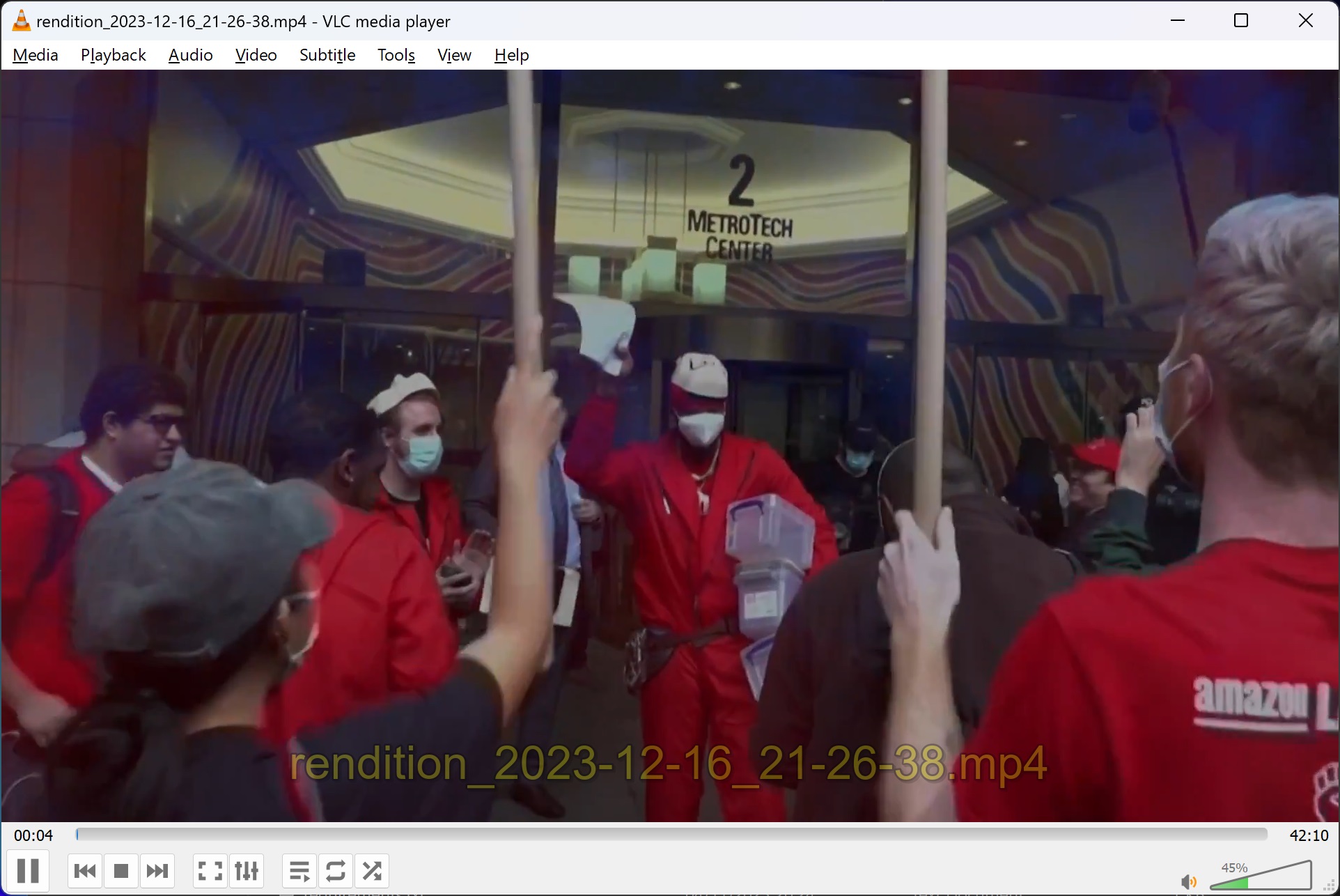

    job done
    [Attachment 75558 - Click to enlarge]
