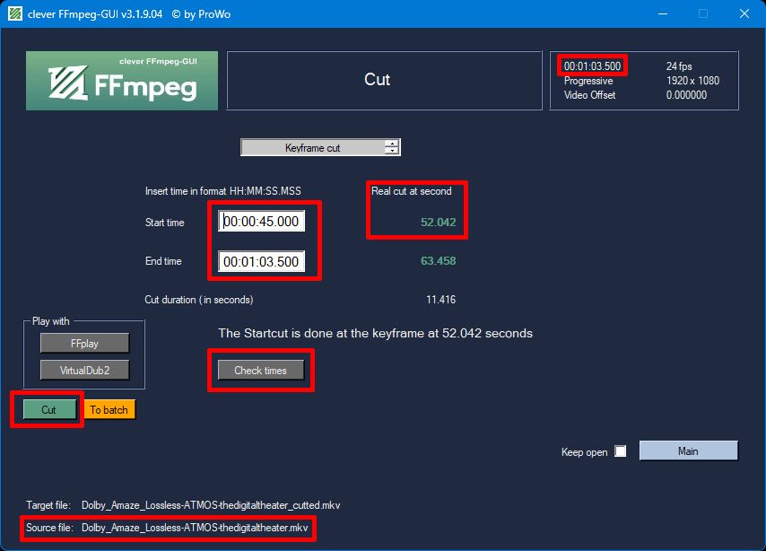

  3. You can try clever FFmpeg-GUI.
    Load your movie WITH the atmos track, click main, click cut, waint until indexing has finished, set your cut time, click check times and finally click cut.
    The cut is done at the nearest keyframe, so it's not frame accurate.

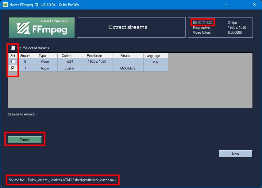

    Click source file, then drag and drop the new cutted piece, click main. click extract streams, select the atmos track on the left and click extract.
    [Attachment 75539 - Click to enlarge]
    Tested here successfully with an atmos track movie.

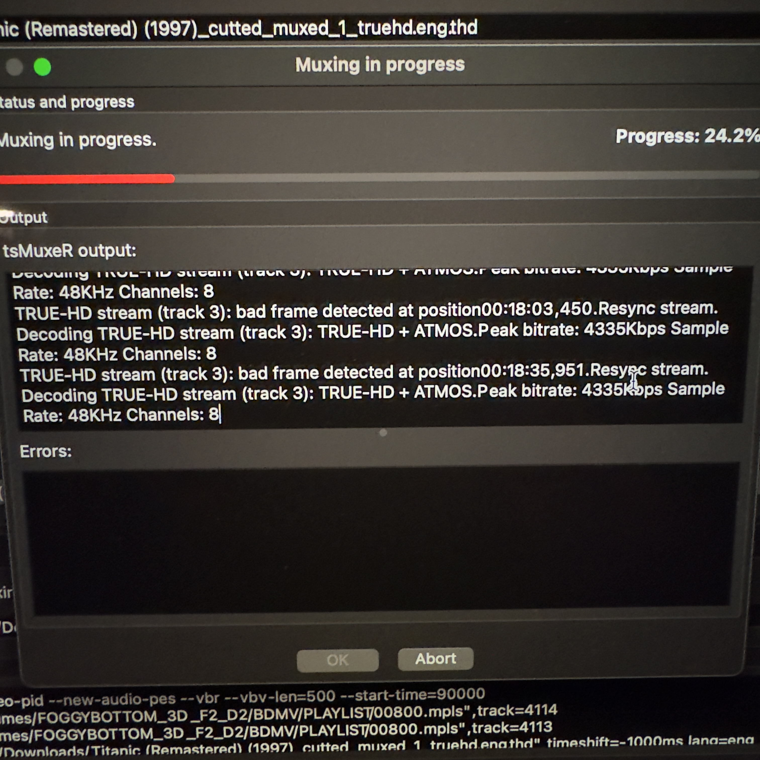

    [Attachment 75542 - Click to enlarge]
    Originally Posted by tangcoma View Post
    Download the last beta (3.1.9.03).
    Oh , I have extracted the Atmos track , but it is 5 seconds less than normal , so it is in sync at the beginning but out of sync at the end , what is wrong am I doing ? So frustrating��*�� Pls help��������*♂️
    Thx , when I use tsMuxeR to remux the extracted Atmos , it show this kind of error , I think this is why the Atmos track is out of sync when I remux it , but I have seen the cutted mkv video, and it is sync in that video ! So what am I doing it wrong ? Thx ����
