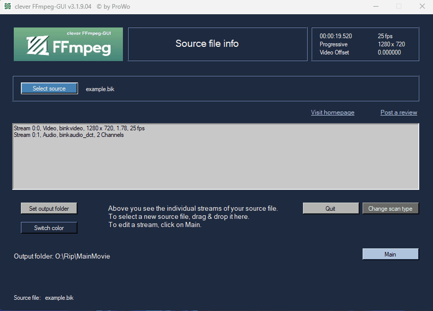

  6. For bik v.1 (codec binkvideo) you can use clever FFmpeg-GUI.
    With bik v.2 (codec kb2g) no avail, because ffmpeg can't decode it.

  9. Originally Posted by Jay123210599 View Post
    My videos all have the first codec, but how will that help?
    You can re-encode the video stream and the audio streams as you wish, e.g. the video stream to h264/avs or hevc, the audio streams to aac or ac3 and then pack (multiplex) the new streams into a new container (e.g. mp4, mov or mkv).
    [Attachment 75555 - Click to enlarge]
