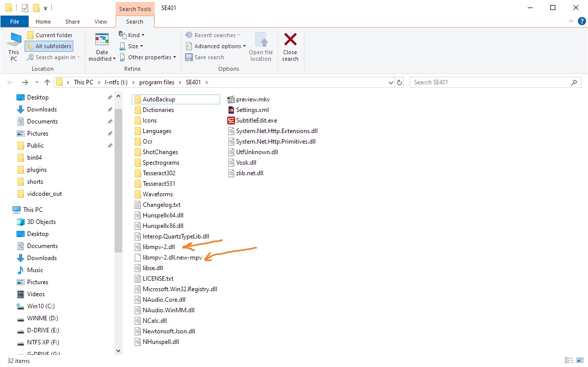

    Close SE and delete these 2 files.
    If your WAVform is not loading there is probably something wrong with the file.
    Or there's an alternative method in the settings where you can setup FFmpeg for this
  5. Dave the screenshot shows what I see--- only one dll not related to mpv on my Win7 install.

  7. Progress...
    Found one mpv dll in users > myfolder > appdata > roaming > subtitle edit > files > libmvp-2.dll
    I deleted that... it is in the trash bin.
    I'll report back after a restart-- or something.
    Mar 2008
    mpv is the video engine, I don't think that's going to affect whether the wavform comes up.
    You should look at problems in the file itself.
    Start off with a mediainfo report to see if you can spot anything, and/or
    remux to a new MKV with mkvtoolnix
  9. Solved.
    Most recent load of the mkv showed the audio window displaying the proper message to click to add wave form
    and the wave form was added properly so far as I can tell without a full work session.
    Then what was the mpv-2 dll doing and why is it not missed?
    Mar 2008
    Originally Posted by loninappleton View Post
    Solved.
    SE doesn't need this file. If you unpack the zip (portable) or do the install,
    that file is not included. I believe it gets added when you click on "download mpv lib"
    on the settings/video player tab
