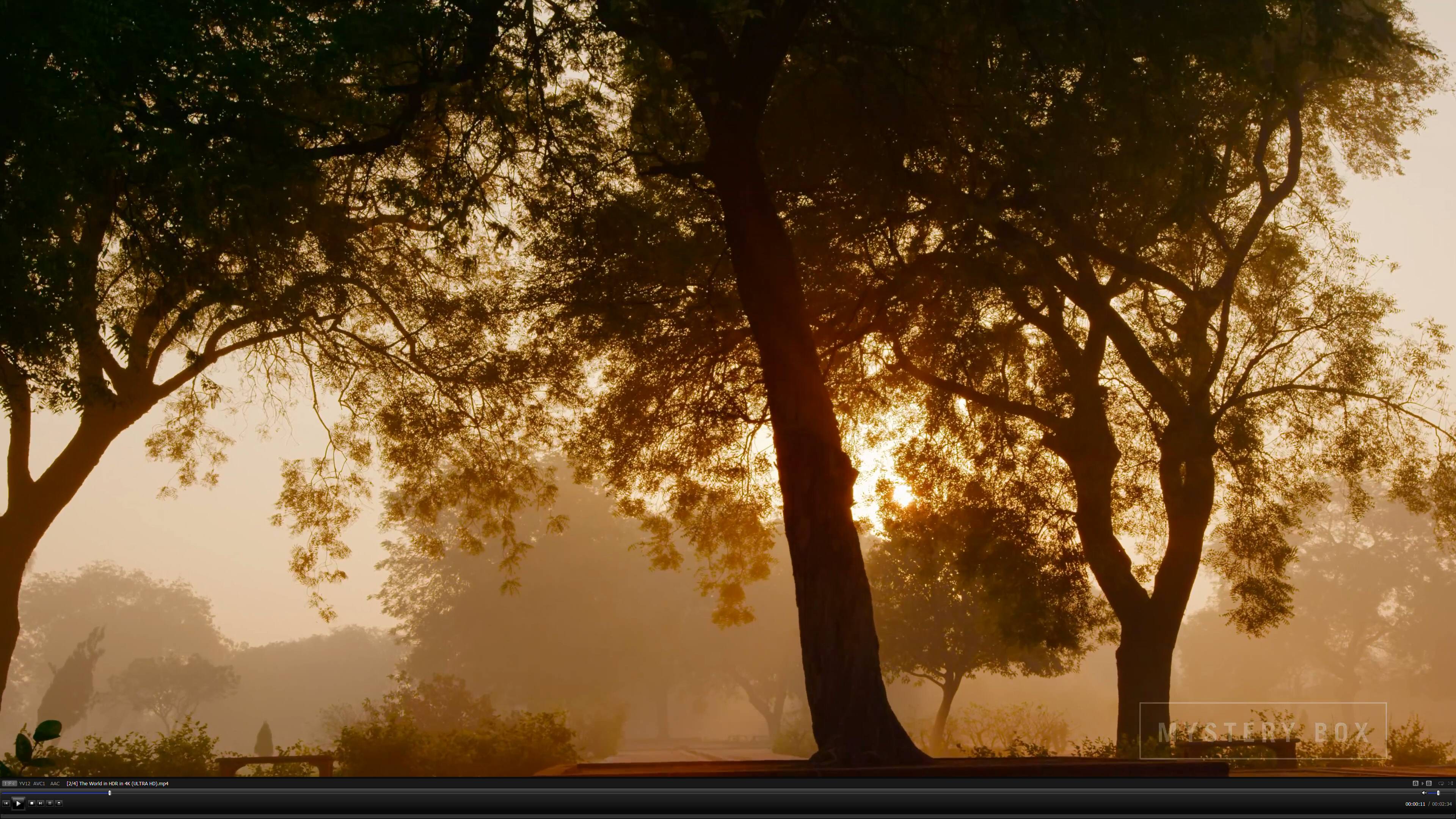

    I have a Dell S2718HN/NX monitor. Although it has a 1920x1080p 8-bit panel, it has a 4K HDR mode and a 1080p mode for its lone HDMI port. The 4K resolution mode isn't set automatically for 4K input. It has to be set manually. The monitor itself downscales the 4K input to 1920x1080 and applies tone mapping to simulate HDR. However, if I take a screenshot when the PC is set up to output 4K video and the monitor is in 4K HDR mode I get a 4K picture.
    [Edit] I forgot to say that the LG 27UL500W monitor does not support high refresh rates for gaming (if that is what you want to use it for), only 50-60 Hz. However, the Dell S2718HN/NX doesn't support higher refresh rates than 50-60Hz either.
    Here is a link to a screenshot I made some time ago while using my Dell S2718HN/NX monitor https://forum.videohelp.com/attachment.php?attachmentid=44162&d=1514325637
