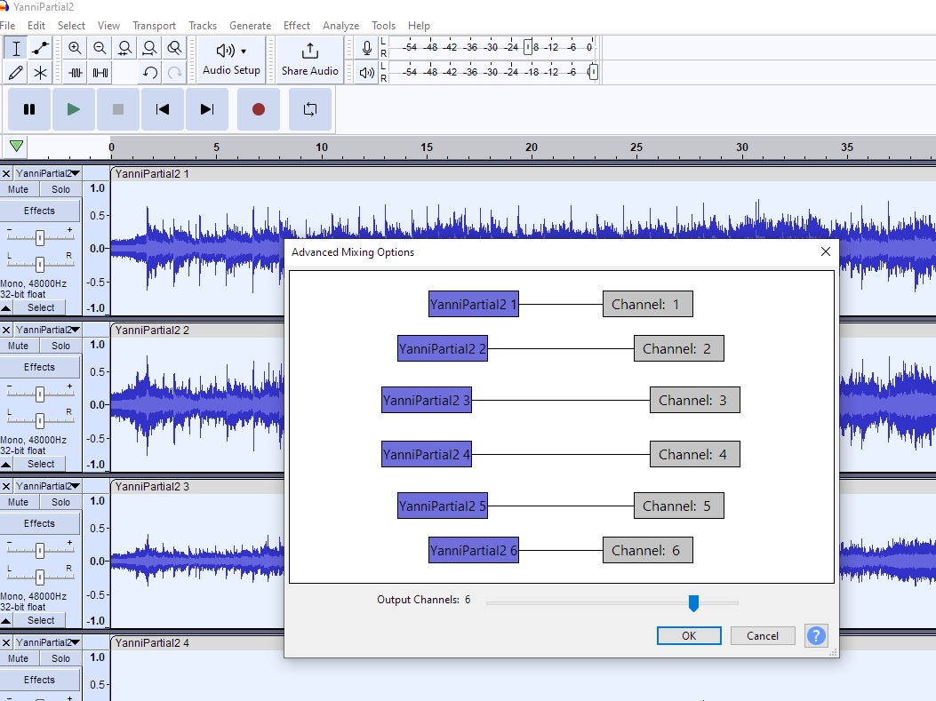

    Well it got blown out when you reduced it to mono.
    I'm really not sure what you're doing. Why convert it to mono? Why don't you reduce the level
    of the channel you're interested in Audacity, and export it as a new 5.1 in the original ac3 format?
    Friend @davexnet, as I said, in the previous post, I made a mistake here, when exporting only SoundForge 16, and it ended up coming out MONO, and I only saw this when you responded, please forgive me, but I fixed my mistake and passed the partial file in 5.1 channels.
    But what I want to say is that even the original, in 5.1, has blown sub-bass, probably because I didn't have a subwoofer in the set and used front speakers in LARGE, and I believe that this actually made things worse, and that's why, I would like to see if it is possible through some plugin to solve this, anyway, thanks for the help
    Att.
    Druid®.
    P.S. I'm going to test your idea friend, I'm going to reduce the LFE channel to -10db and test, then I'll come back to confirm if it's a possible solution .
