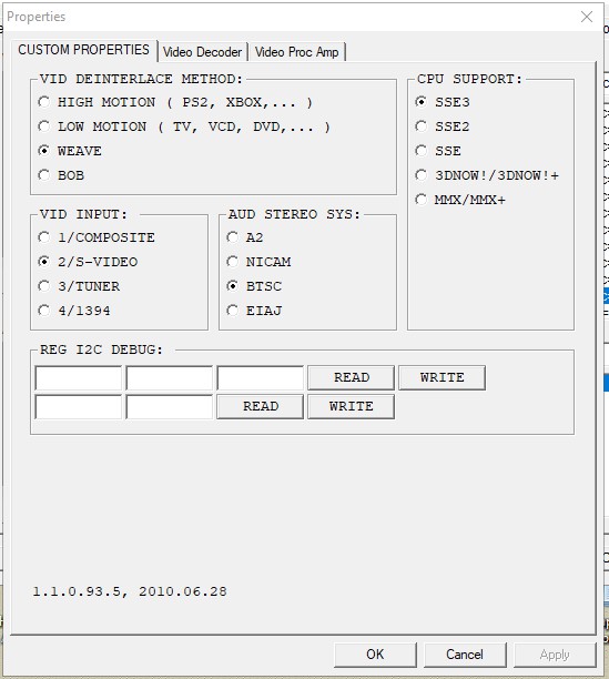

    Kat, certainly, as a first step try AmarecTV. I have posted a guide here. Let us know how you get on.
    You could also try a VCR if you have one.
    The GV driver I am using is the 111 driver. It's at the bottom left of the "Device Setting" screen ("Graph 1(Device)" tab in AmarecTV):
    [Attachment 75401 - Click to enlarge]

    Thank you Alwyn, I'll see if I can manage to give Amarec a shot.
    And yes, those are basically the same settings for video capture that I am using in OBS. Thanks again for your feedback.

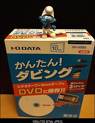

    Lordsmurf, the GV USB2 still runs perfectly on Win 10 and Win 11. Once again, you're critiquing a digitiser that you don't even own
    Oh no! Then what is this?
    ... but that's NOT an endorsement. I test lots of gear, and have for decades. When I write/speak, it's from experience.
    [Attachment 75452 - Click to enlarge]
    Is nothing. You should provide some test showing the (false) remarks you often repeat, rather than a picture of an item that you (probably) just received (recently, in your forum you wrote you were not able to get it).
    Provide facts, and not your usual blah blah
