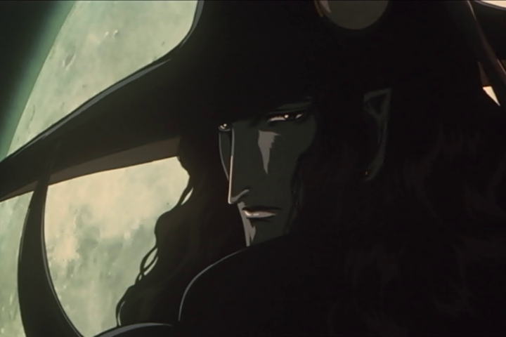

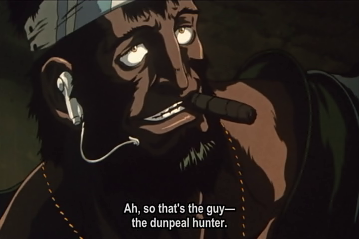

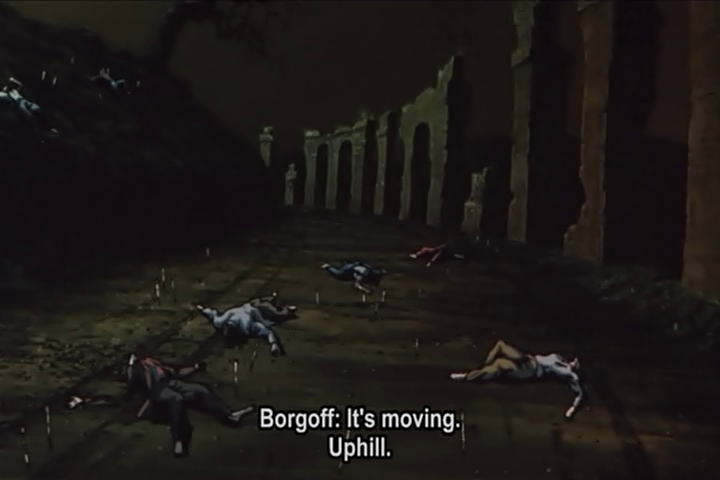

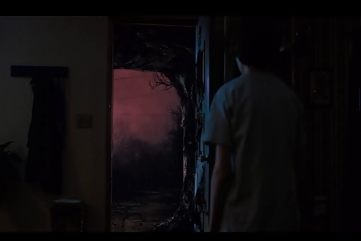

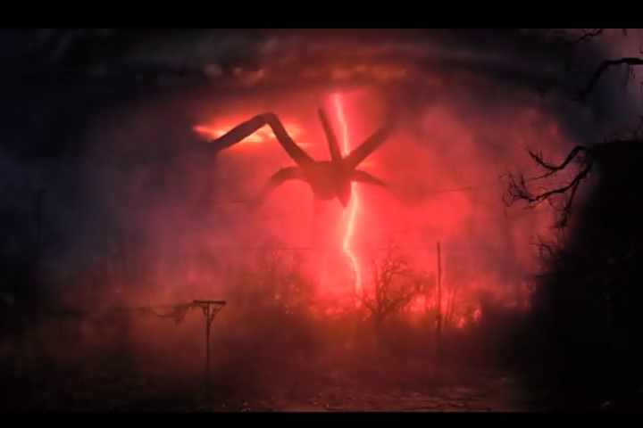

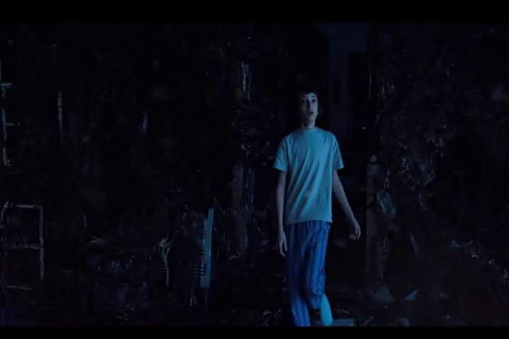

    In my quest to have one encode to rule them all I keep coming back to MPEG-2. It plays on everything from dvd players to smartphones/devices, can be streamable, requires relatively little CPU power, and the patients have expired mostly. One thing I always wondered is if making the GOP longer than 18 really makes a difference. Yes I know it may not seek well, but will it play? well the good news is yes it does and it does well. coupled with ffmpeg using the kvcd matrix (thanks for making this kwag) most of my encodes are ~40% smaller on average vs the standard mpeg matrix and GOP 18. Only major trade off is seeking delay on devices...but how many of us do that instead of letting the movie play. yes even roku's will play these as long as you remux to a mkv file. Attached are samples, scripts, and a DVD iso to try if you like. some caveats before the screenshots:
    --yes I hard interlaced my sources and burned subs. Pretty much every device can decently bob, but cant consistently do pulldown properly and oddly add interlacing artifacts. I mean from your $10 used dvd player to you high end smart tv is what im going for. Subs are burned as not all devices can render properly.
    --all the make it look better stuff (-mbd 2, -trellis 2, etc) oddly hurt visual quality but raise the ssim quality. I guess these were made with the standard mpeg-2 matrix in mind.
    --threads 1 is intentional. more threads cause ghosting to appear as the gop gets longer.
    --3 pass is intentional. pass 1 to get the ballpark, pass 2 for vbr and pass 3 for finalizing and even finer bitrate compliance.
    --pass 0: preprocess and cutpoints:
    ffmpeg -i anime-002.mkv -i anime-002.idx -filter_complex "crop=1912:1036:4:20[crop];[crop]scale=720:480:flags=spline[resized];[resized]colorspace=all=bt601-6-525:iall=bt709[DVD];[1:s]scale=720:480[ovr1];[DVD][ovr1]overlay[subbed];[subbed]smartblur,unsharp[clean];[clean]fps=60000/1001,interlace=tff:0[final]" -map [final] -map 0:a -c:a pcm_s16le -ac 1 -ar 48000 -c:v libx264 -qp 0 -preset ultrafast -g 1 -segment_times 01:29:27.779 -reset_timestamps 1 -segment_list anime-002.cutlist -segment_list_type ffconcat -f segment anime-002-raw%03d.mkv
    ffmpeg -i live-002.mkv -i live-002.idx -filter_complex "crop=1920:960:0:64[crop];[crop]scale=720:432:flags=spline[resized];[resized]colorspace=all=bt601-6-525:iall=bt709[DVD];[1:s]scale=720:432[ovr1];[DVD][ovr1]overlay[subbed];[subbed]smartblur,unsharp[clean];[clean]fps=60000/1001,interlace=tff:0[interlace];[interlace]pad=720:480:0:32[final]" -map [final] -map 0:a -c:a pcm_s16le -ac 1 -ar 48000 -c:v libx264 -qp 0 -preset ultrafast -g 1 -segment_times 01:29:27.779 -reset_timestamps 1 -segment_list live-002.cutlist -segment_list_type ffconcat -f segment live-002-raw%03d.mkv
    --pass 1,2,3 (add remove #'s after 1st pass and fill in bitrate from first pass)
    rm /home/witzel/Desktop/vhelp/live-002-pass1.m2v
    ffmpeg -f concat -i /home/witzel/Desktop/vhelp/live-002.cutlist -vf setfield=tff -f dvd -muxrate 10080k -packetsize 2048 -c:v mpeg2video -maxrate:v 9000k -minrate:v 0 -bufsize:v 1835008 -aspect 16/9 -dc 10 -g 240 -bf 2 -intra_matrix 8,9,12,22,26,27,29,34,9,10,14,26,27,29,34,37,12,14 ,18,27,29,34,37,38,22,26,27,31,36,37,38,10,26,27,2 9,36,39,38,40,48,27,29,34,37,38,40,48,58,29,34,37, 38,40,48,58,69,34,37,38,40,48,58,69,79 -inter_matrix 16,18,20,22,24,26,28,30,18,20,22,24,26,28,30,32,20 ,22,24,26,28,30,32,34,22,24,26,30,32,32,34,36,24,2 6,28,32,34,35,36,38,26,28,30,32,34,36,38,40,28,30, 32,34,36,38,42,42,30,32,34,36,38,40,42,44 -flags +ilme+ildct -alternate_scan 1 -top 1 -passlogfile /home/witzel/Desktop/vhelp/live-002.passlog -threads 1 -q:v 3 -an -pass 1 /home/witzel/Desktop/vhelp/live-002-pass1.m2v
    #rm /home/witzel/Desktop/vhelp/live-002-pass1.m2v
    #ffmpeg -f concat -i /home/witzel/Desktop/vhelp/live-002.cutlist -vf setfield=tff -f dvd -muxrate 10080k -packetsize 2048 -c:v mpeg2video -maxrate:v 9000k -minrate:v 0 -bufsize:v 1835008 -aspect 16/9 -dc 10 -g 240 -bf 2 -intra_matrix 8,9,12,22,26,27,29,34,9,10,14,26,27,29,34,37,12,14 ,18,27,29,34,37,38,22,26,27,31,36,37,38,10,26,27,2 9,36,39,38,40,48,27,29,34,37,38,40,48,58,29,34,37, 38,40,48,58,69,34,37,38,40,48,58,69,79 -inter_matrix 16,18,20,22,24,26,28,30,18,20,22,24,26,28,30,32,20 ,22,24,26,28,30,32,34,22,24,26,30,32,32,34,36,24,2 6,28,32,34,35,36,38,26,28,30,32,34,36,38,40,28,30, 32,34,36,38,42,42,30,32,34,36,38,40,42,44 -flags +ilme+ildct -alternate_scan 1 -top 1 -passlogfile /home/witzel/Desktop/vhelp/live-002.passlog -threads 1 -b:v 1439k -an -pass 3 /home/witzel/Desktop/vhelp/live-002-pass2.m2v
    #rm /home/witzel/Desktop/vhelp/live-002-pass2.m2v
    #ffmpeg -f concat -i /home/witzel/Desktop/vhelp/live-002.cutlist -vf setfield=tff -f dvd -muxrate 10080k -packetsize 2048 -c:v mpeg2video -maxrate:v 9000k -minrate:v 0 -bufsize:v 1835008 -aspect 16/9 -dc 10 -g 240 -bf 2 -intra_matrix 8,9,12,22,26,27,29,34,9,10,14,26,27,29,34,37,12,14 ,18,27,29,34,37,38,22,26,27,31,36,37,38,10,26,27,2 9,36,39,38,40,48,27,29,34,37,38,40,48,58,29,34,37, 38,40,48,58,69,34,37,38,40,48,58,69,79 -inter_matrix 16,18,20,22,24,26,28,30,18,20,22,24,26,28,30,32,20 ,22,24,26,28,30,32,34,22,24,26,30,32,32,34,36,24,2 6,28,32,34,35,36,38,26,28,30,32,34,36,38,40,28,30, 32,34,36,38,42,42,30,32,34,36,38,40,42,44 -flags +ilme+ildct -alternate_scan 1 -top 1 -passlogfile /home/witzel/Desktop/vhelp/live-002.passlog -threads 1 -b:v 1439k -an -pass 3 /home/witzel/Desktop/vhelp/live-002-pass3.m2v
    Considering my bitrates come in 1000k-2000k for 480i video I'd call that not bad. Definetly not HD quality but good enough for my goal. just sharing in case there's anyone else like me that still likes to use old but useful items still from thrift stores etc.
