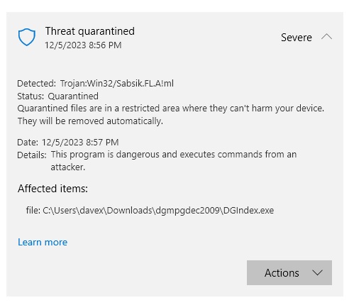

    Thanks selur, didn't know about that version, I'm still using 32-bit 1.5.8 dgindex/dgdecode.
    Interestingly enough when I downloaded dgmpgdec2009.zip, Windwos defender flagged is as trojan
  17. That is strange, it didn't flag it here when I downloaded it.
