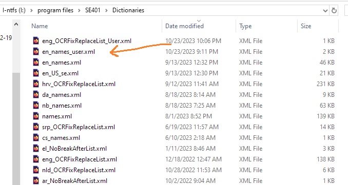

    Originally Posted by Ronstang View Post
    The problem is now I don't know where to find my word and names lists. I looked in the AppData folder under Subtitle Edit but I could not figure out where they were.
    Most important to me are capitalizations. I don't remember how or where I changed those quite a while back. There are a lot of words that are titles that should always be capitalized and I changed them. Things like military ranks etc. should always be capitalized in my opinion. There are a bunch of words I did this with manually adding them somewhere and that list is the one that is most important.
    Anyone know where they are?
    isn't this it?

    FYI Subtitle Edit provides a link to "Open 'Dictionaries' folder". Go Options --> Word lists. In the Word list window you'll see it at the bottom left.
    On my Win7 pc it's C:\Users\***\AppData\Roaming\Subtitle Edit\Dictionaries.
