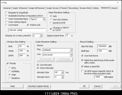

    I have uploaded images of my AmaRecTV configuration and resource usage while capturing here: https://imgur.com/a/qal4yZi

    What have you set here?

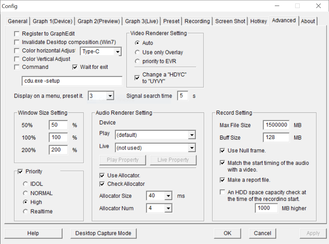

    AmarecTV reports dropped frames in its log files. Enable it with this setting:
    and you'll have all the info about what's going on during capture processing.
    Post the log file here if you need support.

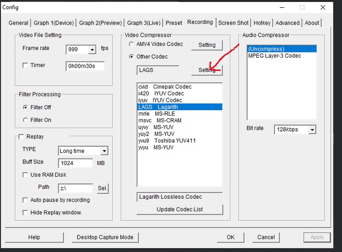

  4. Hello, thank you for the fast replies
    This is my codec settings
    https://imgur.com/a/M4tPvpX

    Mar 2008
    Try setting the mode to yuy2 instead of RGB
