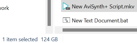

I managed to deinterlace a video using QTGMC via AVIsynth and VirtualDub2, but the output video had a size of a whomping 124 GB! Is there a way to deinterlace videos and get significantly smaller output file sizes? The input video was at 5.10 GB.

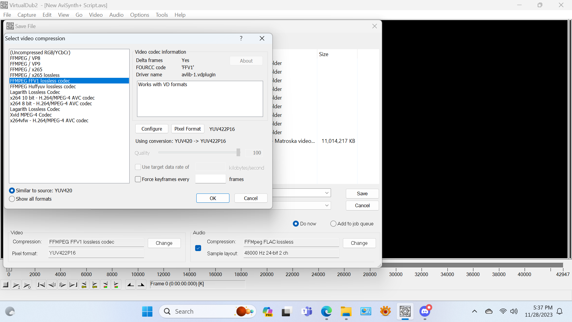

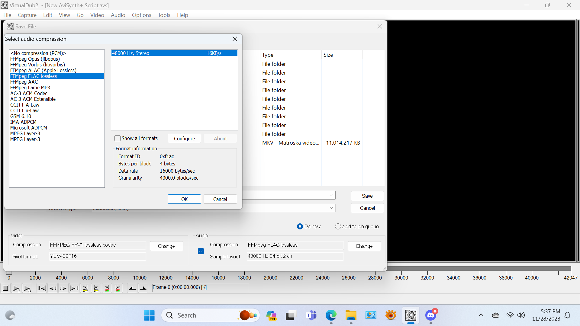

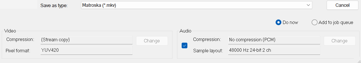

	These are the options for video and audio compression on VirtualDub2. I selected Direct Steam Copy for both and that's how I got the large file.

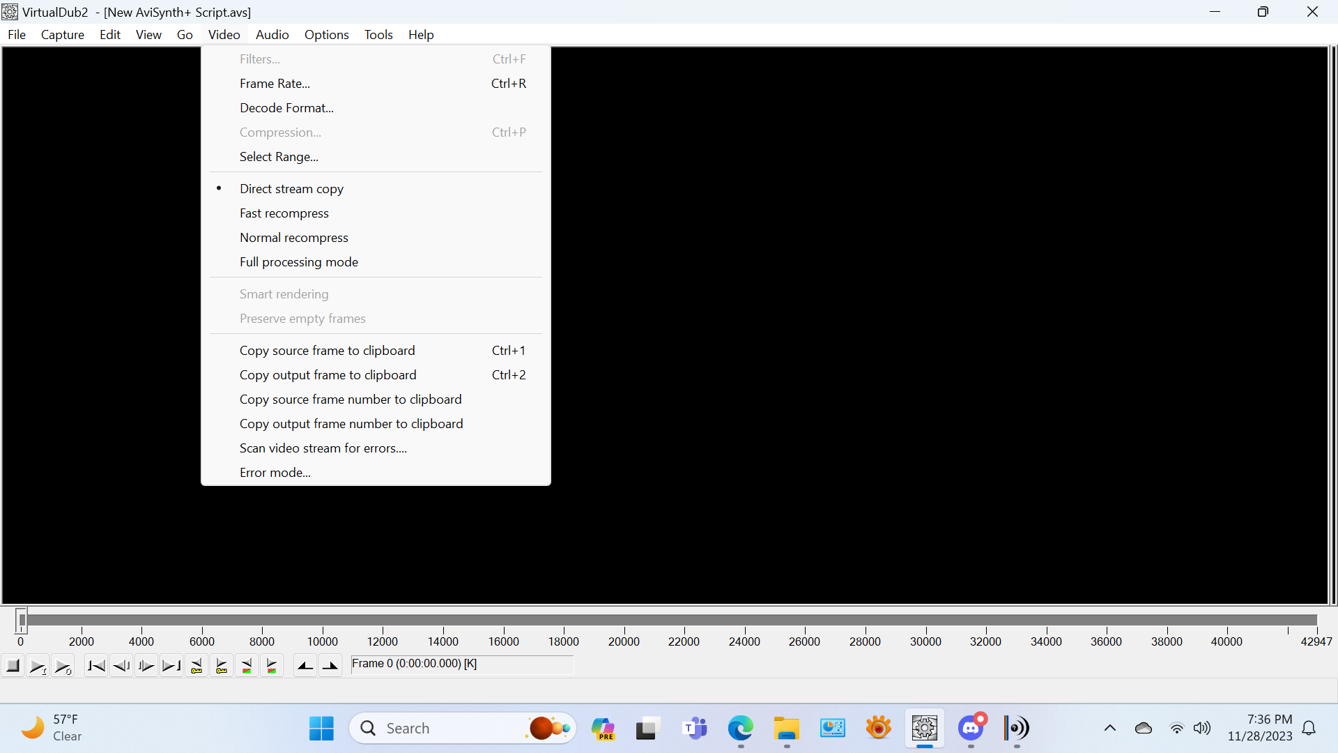

	Direct stream copy is for copying without needing to recompress, which works fine for simple editing (particularly I frame Gop edits). However, whenever you PROCESS video, it must ALWAYS do a full re-encode (to whatever settings you have set, or to some default like uncompressed, if you forgot to set them). It will override direct stream copy option. And QTGMC does Heavy processing (as does many AVISynth scripts).
	For the video (and audio) you don't have Direct Stream Copy selected in the Video menu, because you have changed the Video compression on the Save Video screen. In Direct Stream Copy mode, you cannot change the compression: the button is greyed-out.
 FFV1 does produce very large files (121MB/sec). Other lossless codecs such as HUFF or Lagarith are only around 60MB/sec. What is the purpose of your export? To further edit in an NLE, or give to others to watch? That will determine what video codec you should save with.
 To explain the 5GB>124GB, the 5GB file is probably in the H264 codec, which is a highly compressed format. If you "save" that in FFV1, it's quite understandable you'll get that "huge" increase in size.
 If you had Direct Stream Copy selected, your exported file would be exactly the same as the original: 5.1GB because nothing would have been done to it.I selected Direct Steam Copy for both and that's how I got the large file.

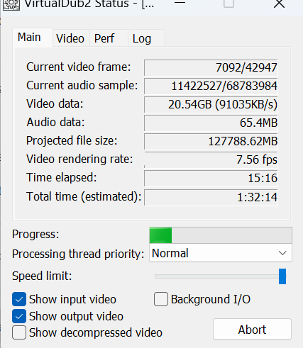

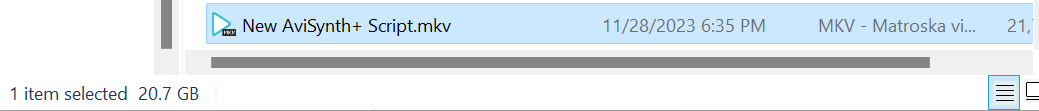

 I decided to deinterlace the video direct stream copy again for only a few minutes and it was already larger than the input.

	I say again, it is not possible to do a Direct Stream Copy and resave that AVS. A direct stream copy simply copies the video as-is, so at most, it will end up at ~5GB, with no processing involved.I used Direct Steam Copy when deinterlacing my last video and it was 124 GB in size. If I used lossless codecs, it will also be large in size?
 You can check the Video menu: you will have Direct Processing mode selected.
 Your "mistake" is that you are using the FFV1 codec to export your QTGMC AVS. That is giving you the large 124GB file size. If you use HUFF or Lagarith, the file size will be at least half that size.

 I have these selected in the video menu.

	Again, to repeat what has already been explained to you:
 1. PROCESSING requires access to the uncompressed form, and since it changes that uncompressed form, it is not possible to return it to a compressed form without RECOMPRESSING it. Examples of processing: Deinterlacing (including QTGMC), Resizing/Cropping, Color changes, Text subs & Picture overlays, Noise Reduction.
 2. EDITING can work either on the compressed form or on the uncompressed form, depending on the original file's complexity, so sometimes requires PROCESSING, sometimes not. Examples of non-processed editing: I-frame GOP editing, Intraframe-only editing, non-destructive framerate changes incl. true ITVC.
 If you choose "Direct Stream Copy" you can only do items in #2. If you choose DSC, then add items in #1, it will either change your selection to Full processing mode or it will simply ignore your setting, override it to Full processing mode, and either way will require a recompression.
 If you recompress, you MUST set the compression settings. If you forget to set those settings, it will use the default, which usually happens to be UNCOMPRESSED. Which means HUGE files.
 If you set your PROCESSED ("QTGMC'd") video to x264 or x264vfw in the Video settings, the usual accompanying settings would be 4:2:0 colorspace, 8bit, and then you should set the bitrate to whatever bitrate happened to match what your x264-compressed source was. (Example shown was VBR, averaging 28.3Mbps. 23m52s of that works out to: 28.3 Mbps * 1432sec = 40525.6 Mb or 5065.7 MB or 4.9469 GB).

	In other words, I should select a video compression format in VirtualDub2 because selecting Direct Stream Copy will only use the uncompressed video as the output.
	It's all in my guide I linked to in post #12.What should I put in for video, compression, and x264?
	Jay, just to confirm, the process we're talking about is:
 Open your AVS (containing the QTGMC function) in Virtual Dub. On the Video and Audio menus, choose "Full processing mode", otherwise nothing will be changed in your video.
 Do your editing if needed, then do a File>Save Video...
 Then you set up the x264 parameters and convert your video to h264/MP4.
 You don't convert to H264 in the script itself.
