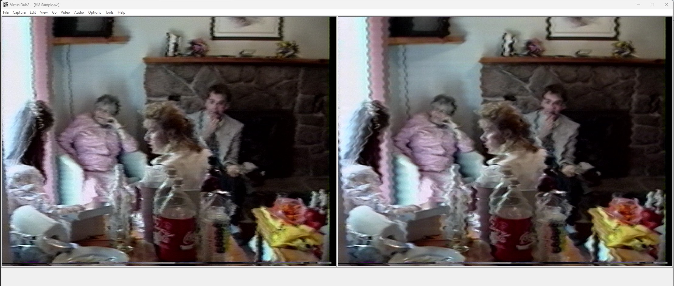

Another aspect of that tape is the interlacing. Both VDub and QTGMC produced some bad wobbly lines. I'll be interested in what the AVISynth experts have to say about this:
[Attachment 75133 - Click to enlarge] -
The video clip can't be deinterlaced properly because it has been resized. It has a resolution of 720 by 540, but NTSC video should have a vertical resolution of 480. It has probably been resized at some stage to achieve an aspect ratio of 4/3. There are filters for Avisynth to undo this sort of thing, but of course in this case it just makes sense to re-capture the footage properly, without resizing.
As for the actual issue with the lines or dropouts, if they are indeed caused by the capture signal path (e.g. they happen randomly), and you can't get rid of them otherwise, taking a median of several captures can be a viable solution. -

Just add it as a filter, find a frame with a uninterrupted section such as a wall, hit Build Nosie Profile then drag out your box in the smooth/constant area (as big as you can but don't worry if you don't get a green box), then click Auto Profile. I didn't make any special adjustments and it removed 95% of the line artifacts. Pipe up if you need more detailed guidance and I'll make a short video.I don't suppose there's a tutorial anywhere that explains how to get rid of those lines with Neat Video, is there?
