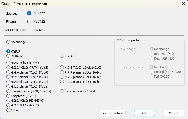

    Ive also been using the default RGB24 pixel format to encode all of my captures so far. Is this going to be a problem?
    You are introducing a lossy conversion to RGB, small: https://forum.videohelp.com/threads/359657-If-I-convert-from-YUV-to-RGB-I-loss-quality
    Respect the input range 16-235 before colorspace conversion: http://avisynth.nl/index.php/Convert
    So dv captures should be encoded straight to huffyuv
    Not at all. Only if you need an intermediate file in the middle of your post-processing (which is quite uncommon), you save it as lossless (i.e. HuffYUV)

  4. Originally Posted by lollo View Post
    This is disheartening to hear as I have encoded many hours of captured tape using the RGB pixel format.
    Does this tape need to be recaptured and will there actually be a noticeable difference to the naked eye if I recapture and encode with the correct setting?
    [Attachment 75525 - Click to enlarge]
    Can you let me know what which option to select please?

    Small/ no visible loss, no need to recapture.
    4:2:2 YUY2.
  6. Capturing Memories dellsam34's Avatar
    Jan 2016
    I don't think it's worth recapture unless you are anal about it. Notice when you choose 4:2:2 YUV2 the options on the right for YCbCr will be active and when you are outputing SD leave everything on "No change", If outputing HD (1440x1080) or higher tick Rec.709, I usually leave component range alone but some members may have a suggestion for HD.

    Here's my workflow:
    1. Capture DV using Win DV (Aspect Ratio is 4:3, Resolution is 720 x 576, 25 FPS, Interlaced)
    2. Open in VirtualDub2
    3. Apply the following filters:
    • DeInterlace
    • De-Noise - Using MSU De-Noiser (Set scale to around 80)
    • Resize to 768x576
    4.Video set to Full Processing Mode
    5. Save Video Compression Huffyuv Pixel Format YUYV, YUY2
    Look and sound ok in Windows Media Player. If you open them in Virtual Dub the sound starts and stops?

    @Dellsam43, again (post 84), can you confirm that when you mention YUV2 you actually mean YUY2?
    I think we're off on a tangent. Capturing with HUFF or LAGS always results in YUV colour space, not RGB (at least here it does). In capture mode, you can't choose RGB in HUFF. In LAGS you can, but it is ignored by AmarecTV and VDub, which captures YUV.
    The dialog box in post 87 (with the various colour spaces and Rec 601/709) is not a capture screen; it's an output/save as screen.
