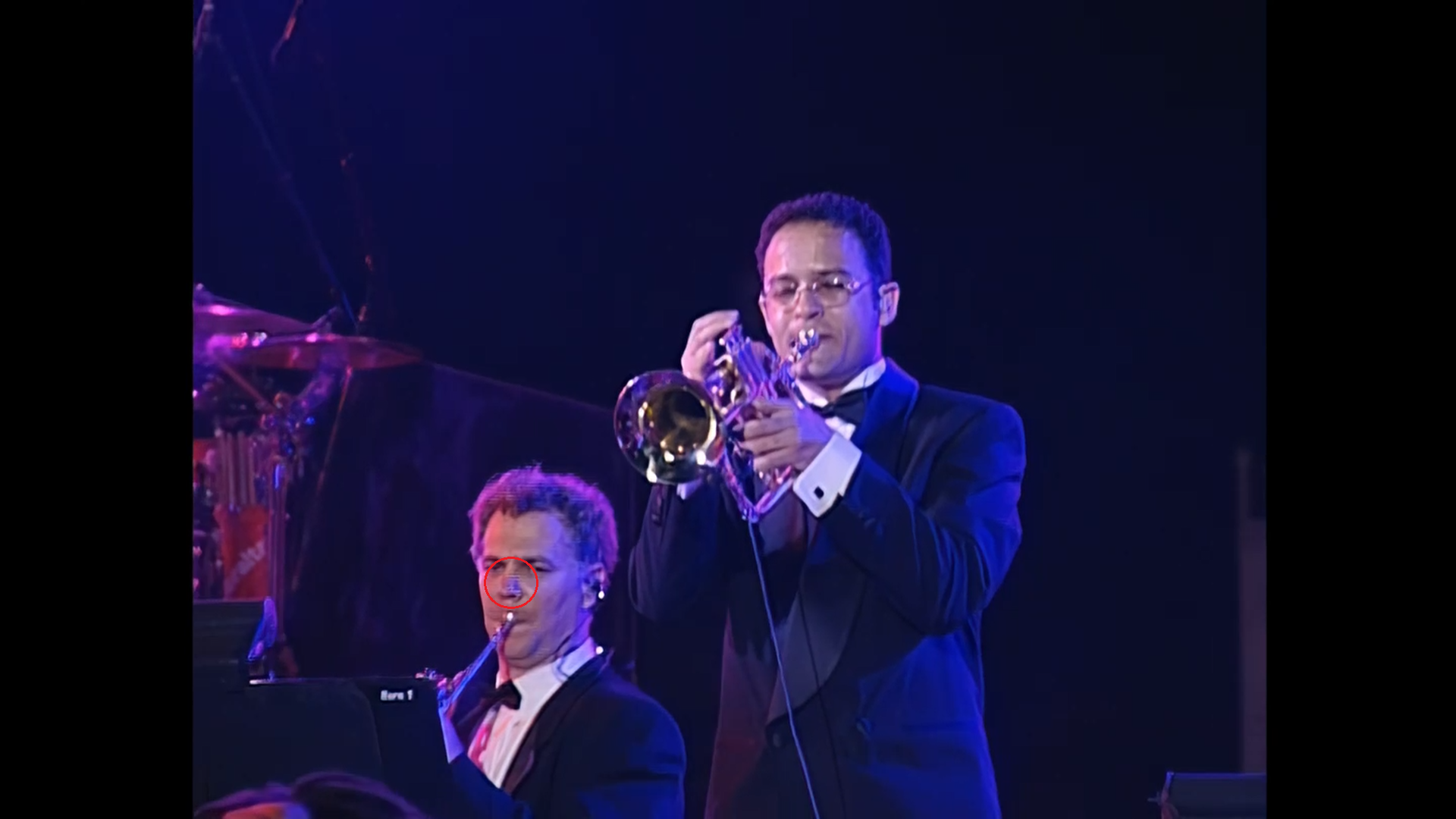

    I have an NTSC video, part of it, and I would like to know what is the best way to deinterlace it, that is, a 480i to 480p, so I can use it in Davinci Resolve 18 and do an Upscaling to FullHD and/or 4K.
    I used the direct interlaced video, and there was a jittery artifact at the top of the video, and even using the Davinci deinterlacer it didn't work.
    What would be the best software to do this? I have Megui and Hybrid installed here, I saw comments about AviSynth and FFMpeg, can anyone guide me about Scripts and how to use them so I can get the best deinterlacing please.
    Here is the part of the file I mentioned, as it is showing artifacts on the nose of the second trumpet player behind the main one in an Upscaling to 1080p in Topaz Video AI v.4.0.4, using the DIONE TV preset.
    Topaz Video AI v.4.0.4 video:

  9. Any AviSynth deinterlacer seems to do a better job than the Topaz AI crap. One does not even need to jump onto QTGMC
    ffms2("Yanni - Tribute (1997 DVD-9 720 x480)__00012.mkv")
    BWDIF()
    And b.t.w. why always jump onto the bandwagon of deinterlacing and upscaling? Too many good video is just getting spoiled....

    Well my friend @Sharc, I partially agree with you, this Yanni show, as it was well recorded, and using the current Topaz Video AI v.4.0.4 preset, DIONE TV, gave a great result in Upscaling up to 1080p , looking like an HD video, it was not perfect, but considering the limitations of the older versions in which the human faces of the audience and the distant artists on the stage looked blurry or like a gouache painting, now they are almost perfect, my only complaint was these artifacts on the musician's nose, otherwise it was very good, not perfect, but very good, really looking like an HD show.
    It is visibly clear that these AI work much better for HD and FHD content than SD content, but they don't say this, and I know that there is a lot of content on DVD, VHS, TV, in SD that currently most software is not capable of to recover.
    I noticed that Davinci Resolve 18 Upscaling does a good job for HD and FHD content, but SD, by far Topaz Video AI is light years better, with stable and more pleasant images.

  19. Now I saw my friend @Selur, the script you made to UpScale the 480i video to 1080p, I just don't know where to apply it, could you guide me please.
    The script I used is a Vapoursynth script, which I created in Hybrid and it's torch addon.
    I used QTGMC for deinterlacing, cropped, then used CodeFormer followed by DPIR denoising which I applied with a limit mask to only filter suff with a luma value <=80, then I appplied CAS and used NNEDI3 to resize.
    Funny that the result in mediainfo doesn't say that the result was a progressive video
    If mediainfo does not report that the source is interlaced, its progressive.
    Also av1 does not support interlaced encoding.

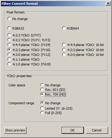

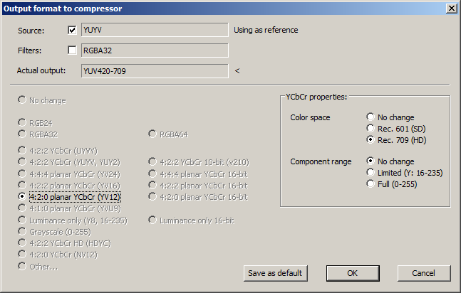

    If one is careless there is a 50% chance that things go wrong.
    Only if the tools you use do not know how to respect color matrices. And if that is the assumtion you could also encounter a player/whatever that doesn't use 709 but always something else,...
    Cu Selur
    Ps.: I agree that adding a color matrix change to 709 might be a good idea when encoding for distribution.
    Friend @Selur, I sincerely thank you for all the answers and help for me here on the forum, but as I'm a complete noobie, I use GUI tools and even so, for me HYBRID and MEGUI are complex applications for my level of knowledge , which I think is in relation to you and the people here of just 1% .

    But there are pitfalls as well e.g. with the colormatrix (601 vs 709). If one is careless there is a 50% chance that things go wrong.
    Indeed, I still am not 100% what exactly I need to do when up-rezzing video in VDub: should I select Rec. 709 in the compressor, or should I use Convert Format filter, or something else.
Name:	compressor format.png
Name:	Convert Format filter.png
