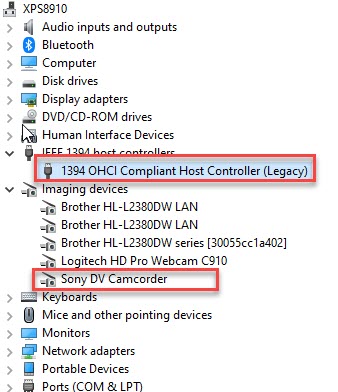

    I'm trying to capture Digital8 video from a Sony DCR-TRV350 via an iLink/firewire cable, but have had no success so far. I've installed a LinksTek PCIE card (PCIE-1394A) and the Windows legacy 1394 driver (procedure in this video). Both the PCIE card and the camcorder ("Sony DV Camcorder") are showing in the Device Manager without any warnings or errors.

    Windows still recognizes the card. One thing that's different is this. . .
    Previously, when I changed the IEEE 1394 host controller driver, Windows would prompt me that there's been a hardware change and ask if I want to restart the computer. Now, when I switch drivers I do not get that prompt.

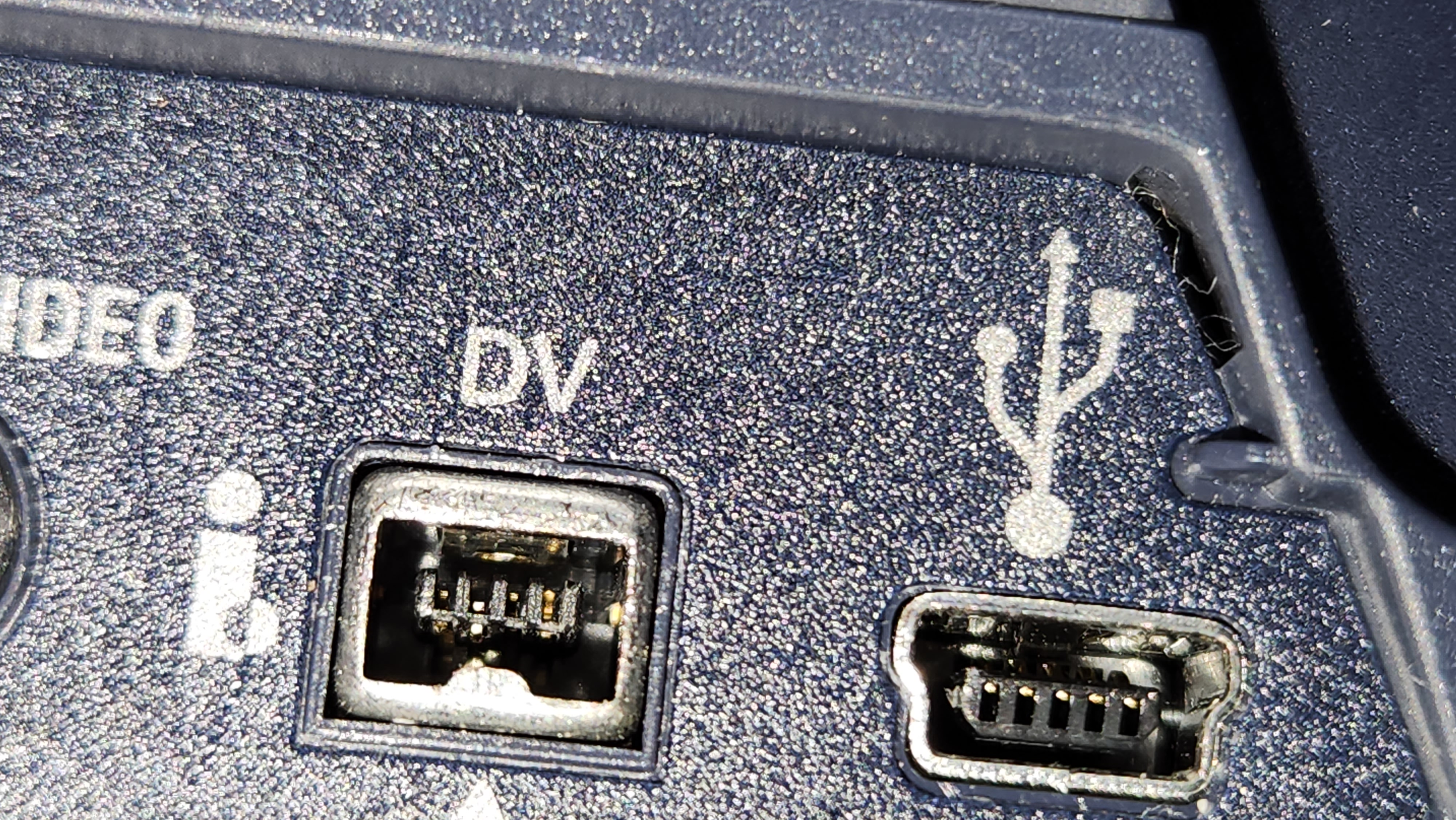

    I replaced the PCIE card, but that didn't help. There were a couple of posts I read along the way that suggested the ports in the camcorder can be fragile. I'm thinking the pins in the port may have gotten bent:

    They're difficult to see and I don't have anything to compare it to. I also don't have a different FW400 device I can test the card with. I'll have to see if I can find a replacement port/board for the camcorder.
  17. Capturing Memories dellsam34's Avatar
    Jan 2016
    Replacing the iLink port on the camcorder is a much more involved repair task, You would need to take the camcorder a part and may need to use heat gun if the soldering gun can't do the job, It is as delicate as removing SMD components.

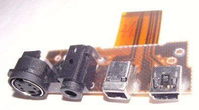

    Hopefully not too difficult in this case. I've seen a few YT videos on disassembly (doesn't that alone make me an instant expert? ). It looks like the part is connected via ribbon rather than being soldered:
    [Attachment 75336 - Click to enlarge]
    I'm pretty good at dis/assembly, and I only need this camera for its playback capability. Plus, I found a used part online for about $19, so I don't have much to lose at this point. If I have to, I found someone experienced who will fix it for around $125. That sounds expensive, but retrieving those memories from the cassettes would be worth it for us.

    See first if you can get a working camcorder for less than what you are going to spend on repairs, if not, make sure that's the problem first, you could spend time and money on replacing the iLink port but will not fix the problem.
    Nov 2023
    Michigan, USA
    Good point - for sure!
