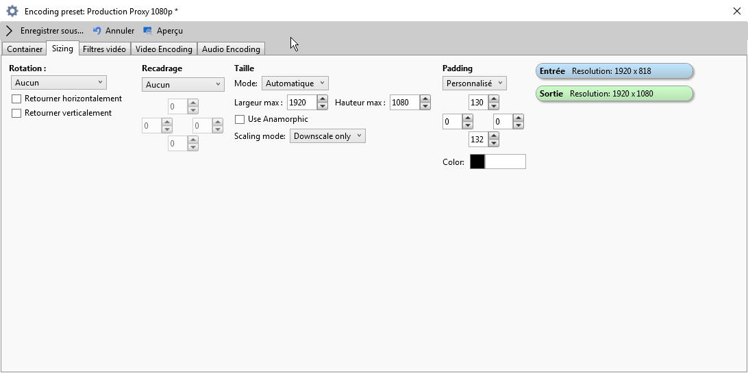

    So, I found how to uncrop with VidCoder (see attached file), though the file is now gigantic (from 4 gigas to 20).

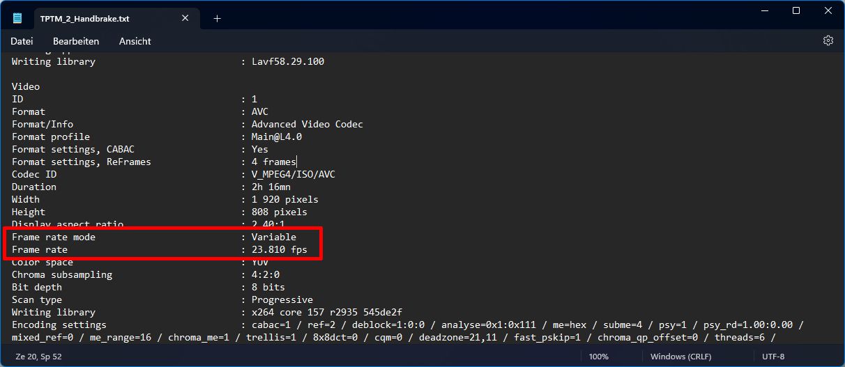

  4. This will cause you difficulties when recoding and synchronizing.
    [Attachment 75090 - Click to enlarge]

    Luckily, VidCoder did a good job, reencoding with black stripes. I now have a h264 uncropped mp4 version (28 gigas).
    And I could compress it into a mkv file (3 gigas) with XmediaRecode.

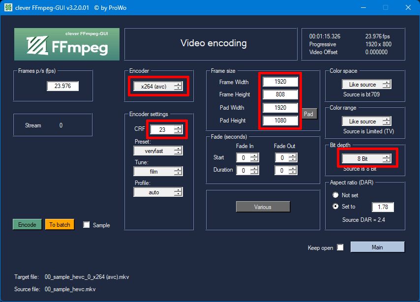

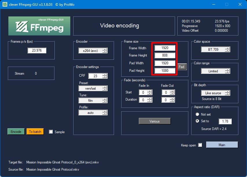

  6. Use the clever FFmpeg GUI:
    Then do the following:
    1) Load the original mkv video (1920x808), click main, click various, click fix timestamps, write in FPS field 23.976 and click fix.
    When this is done, play the new file (beginning, middle, end) to check if everything works correctly and is synchronized.
    If yes, then
    2) Load the new file (with the fixed timestamps), click main, click encode video stream, click resize, select the desired encoder (x264 or x265), select crf 23 for x264 or crf 25 for x265, select the framesize as in the photo and click encode.
    When this is finished, click multiplex, the newly created video stream with the black stripes is green.
    Drag & drop your French subtitles, select all streams on the left except the original video stream (the blue one), this must be deselected.
    Then select the desired container (mp4, mkv) at the bottom and click multiplex.
    This way you only recode your video once and minimize further loss of quality.
    [Attachment 75108 - Click to enlarge]

    After having downloaded the 2 programs, I followed the 1rst part, but for each try I got 23.810 framerate for the new files. What went wrong?
  8. Then it seems that the video was actually encoded at 23,810 fps (very strange).
    Then omit point 1), load your old mkv and continue with point 2 (post #6).

  10. No need to encode with 10 bit. Change to 8 bit in the video encode screen.
    As i wrote in post #6:
    When the videostream encoding has finished, click multiplex, the newly created video stream with the black stripes is green.
    Drag & drop your French subtitles, select all streams on the left except the original video stream (the blue one, it must be deselected).
