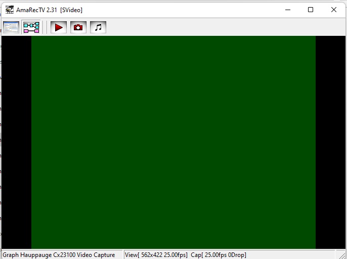

  5. Finally got around to trying a passthru with my working Bush VCR and my Panasonic combo, but for some reason it won't detect the signal from the BUSH video. i remember trying this once before awhile back using the instructions given on here and it didn't work then. I have used a scart to comp cable with the scart end in the back of the Bush video then from there I connected the compostite connections into the back of the Panasonic, and then using an S-video cable from the back of the Panasonic's S-video out and then into the S-video the capture device's S-video cable and the device's USB into the laptop. All I am getting is a greenscreen. I also tried the S-video on the front of the Panasonic, but it's the still the same, no signal. And yes I changed to S-video in the settings, but even in composite nothing but a black screen.
    [Attachment 75307 - Click to enlarge]
    Can someone help please as it's doing my head in. I've tried every connection possible and it doesn't won't detect the signal. Maybe the Panasonic is faulty. I can't get rid of the tape loader making a noise as it's jammed. I tried connecting the Panny on its own and there's a distortion in the video feed, so looks like the machine is faulty, no idea why as the last time I used it before the tape loader jammed it was working perfectly. Maybe the loader has knackered the machine. I decided to hook up my old Panasonic DVD recorder (DMR-E30) and there's a signal detected from the DVD recorder with a menu screen, but nothing from the BUSH VCR, so I must have got the connections mixed up somewhere. Will the passthru work on the DMR-E30? it's not a combo though just a DVD recorder.

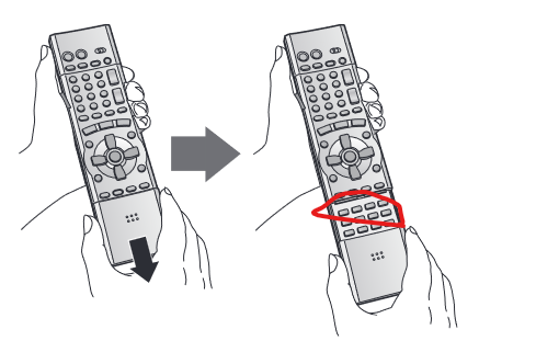

    Worth noting with the panasonic DVD-recorder/VCR combos also is that they have separate input select for the vcr and dvd side so you have to make sure you are selecting the input for the dvd-recorder side.

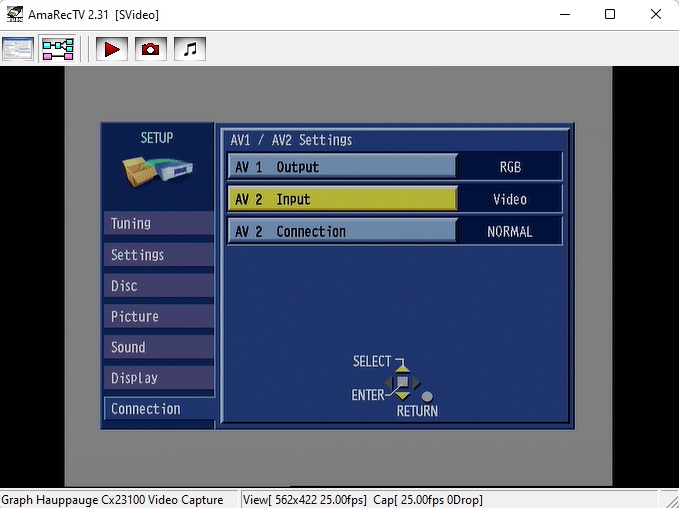

    Thanks for that, but I'm still not getting any signal from the BUSH VCR only the Panasonic that it is connected to. I have connected the scart-comp cable into the scart input in the back of the BUSH video and then connected the comp cables into the inputs on the front the Panasonic DMR E-30 (no point trying to the combo again as I think it is probably faulty as you mentioned), and then using an S-video cable I've connected this to the S-video out on the back of the Panasonic to the capture device via its S video connection, but still nothing except the input from the Panasonic:
    [Attachment 75312 - Click to enlarge]
    Is there a button on the remote or in the settings I need to use?.

  9. Are you selecting the front input as the channel on the E30 with the remote or front buttons? (I think it should be AV2)
    Are you using the right scart connector on the VCR? (if it has multiple scart connectors) The one that does output, not just input.
    Are you using a scart->rca adapter that does output, not just input and is switched to output mode?

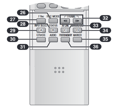

  12. On the Panny remote there is a "INPUT SELECT" button (button 29). Toggle it to select the connected input.

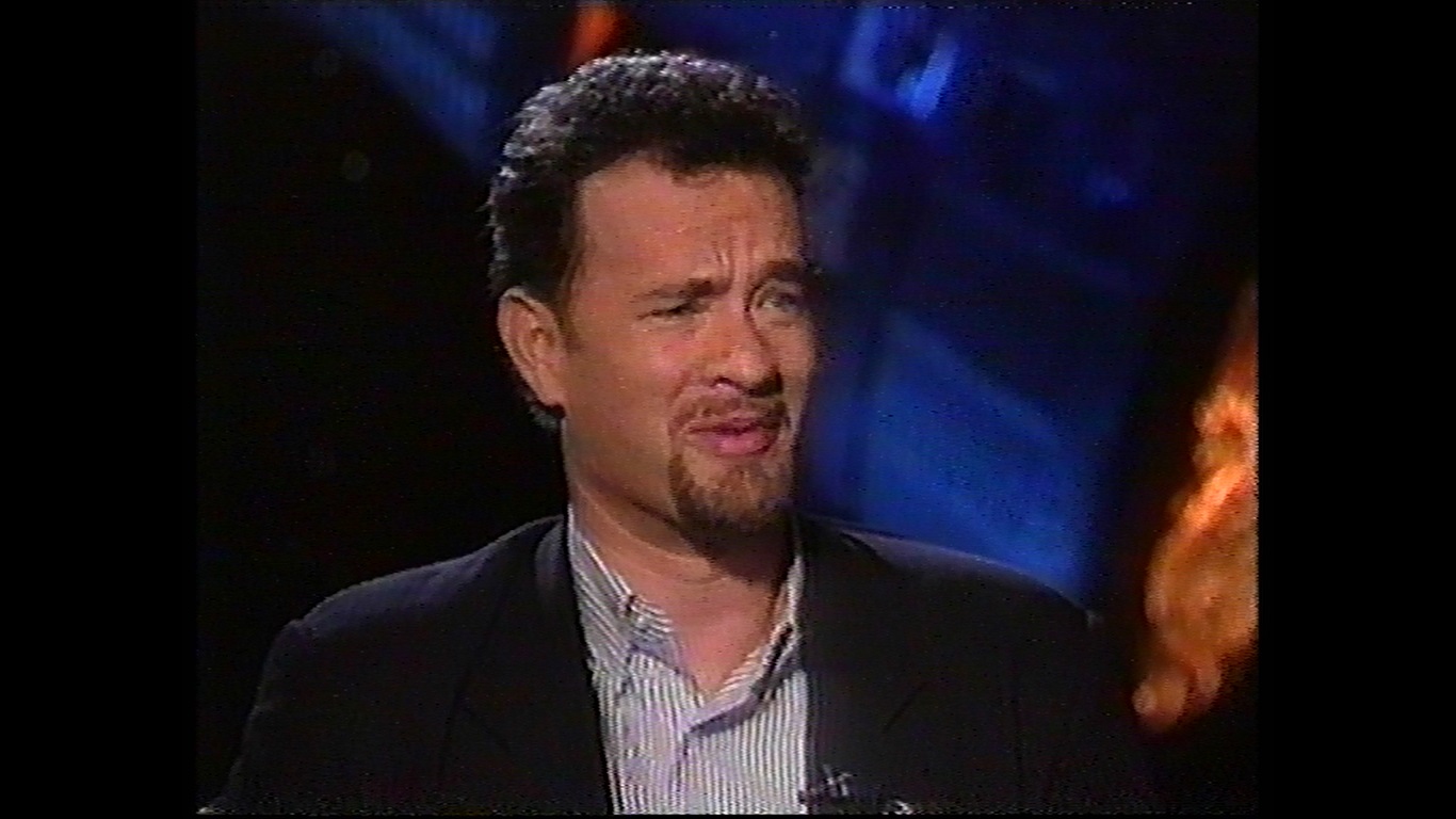

    Thanks for that, tried the channel select and managed to get a signal through:
    [Attachment 75324 - Click to enlarge]
    Looks like it's got rid of that yellowy tint. I wonder what was causing that.
    As oln pointed out earlier, a bad reaction of the capture card to an unstable signal (and not a driver issue as I have experimented in the past and suggested as potential cause)

    Yes it is as you say likely down to unstable video signal. I used the combo for the capture as the DMR E-30 kept shutting down, but the compo keeps trying to load a tape and the mechanism is jammed and I can't find a way of stopping it. I tried loading a tape but the idlers don't lace the tape all around and just unwinds after a few seconds. Here's a video I took, hopefully someone can help as it is annoying. Obviously if a tape would load I wouldn't need to use a second VCR as a passthru:
    https://forum.videohelp.com/attachment.php?attachmentid=75325&stc=1&d=1701949238
