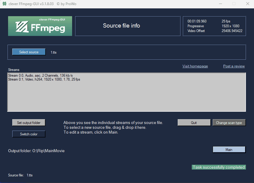

  5. The video timestamps are totally corrupt.
    You can try to regenerate them.
    Use clever-FFmpeg GUI.
    Load your ts file and proceed as in the video.
    First the video track is regenerated with correct timestamps and packed into an mp4 container,
    then this new mp4 video track is muxed with the existing audio track of the ts file into an mkv container.
    [Attachment 75064 - Click to enlarge]
