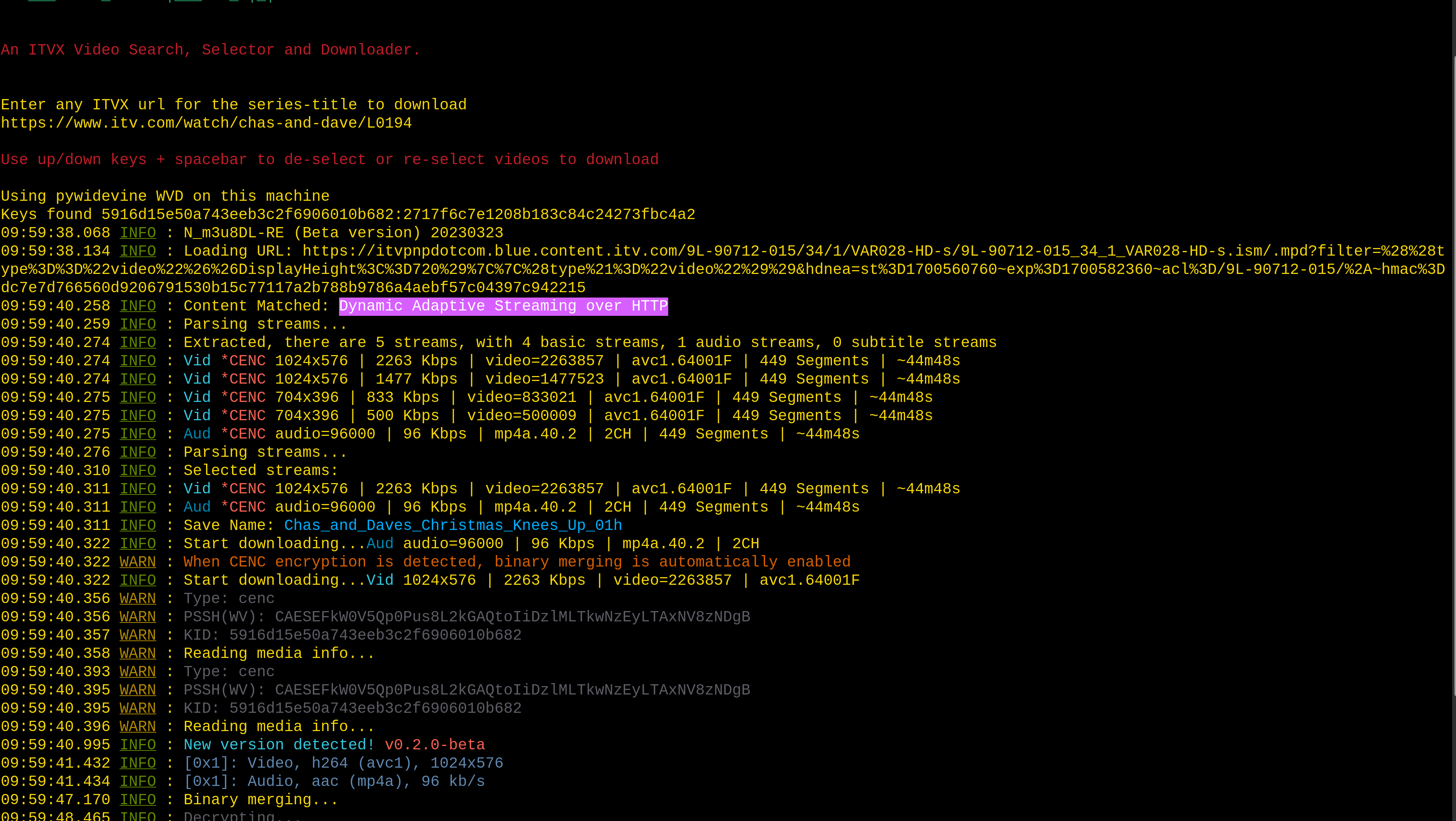

    [Attachment 75002 - Click to enlarge]
    The image is from an ssh connection to my phone doing the grunt work.
    I chose series ITVX and not to search. So with a directly pasted entry of your url it found an extended url which downloaded fine.
    The single downloader failed because the url provided is not complete. Using the series command, it looks for for all titles related and found the correct single item url.
