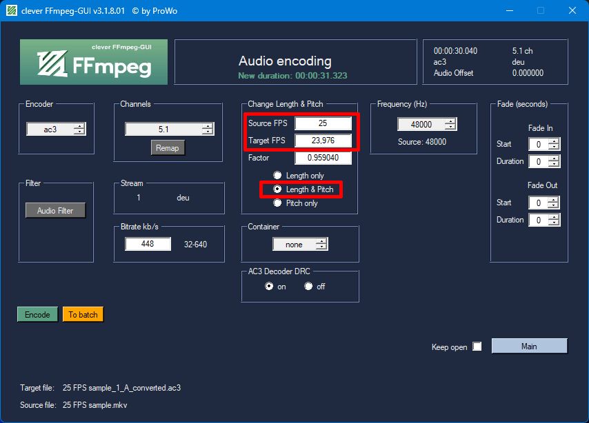

  9. If I understand correctly, you want to mux the DVD audio with the BD video.
    Then why so complicated via avisynth?
    Use clever FFmpeg-GUI.
    Load your DVD video, click main, click encode audio stream, select the audio stream (if there are several), click >>>.
    Then select as marked in red on the photo and click encode.
    Done.
    You have now your new audio stream with the adjusted length and pitch.
    [Attachment 74954 - Click to enlarge]
