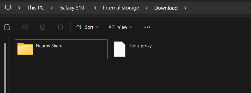

  4. Adding hola Proxy to Freevine on the phone
    Download
    https://github.com/Snawoot/hola-proxy/releases/download/v1.13.1/hola-proxy.linux-arm
    rename to hola-proxy
    if your phone is connected via usb copy to download directory
    [Attachment 77523 - Click to enlarge]

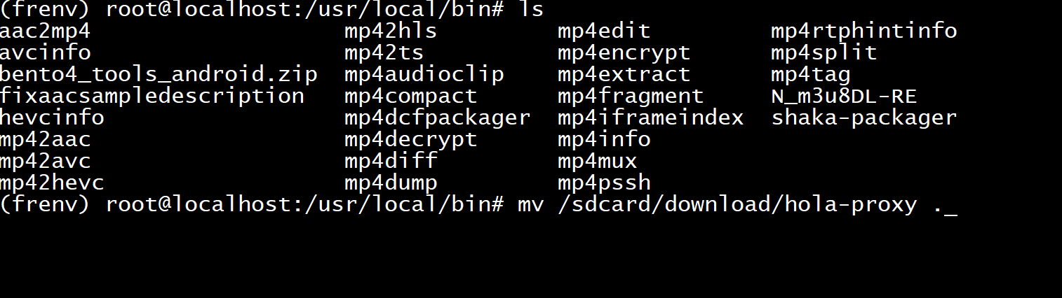

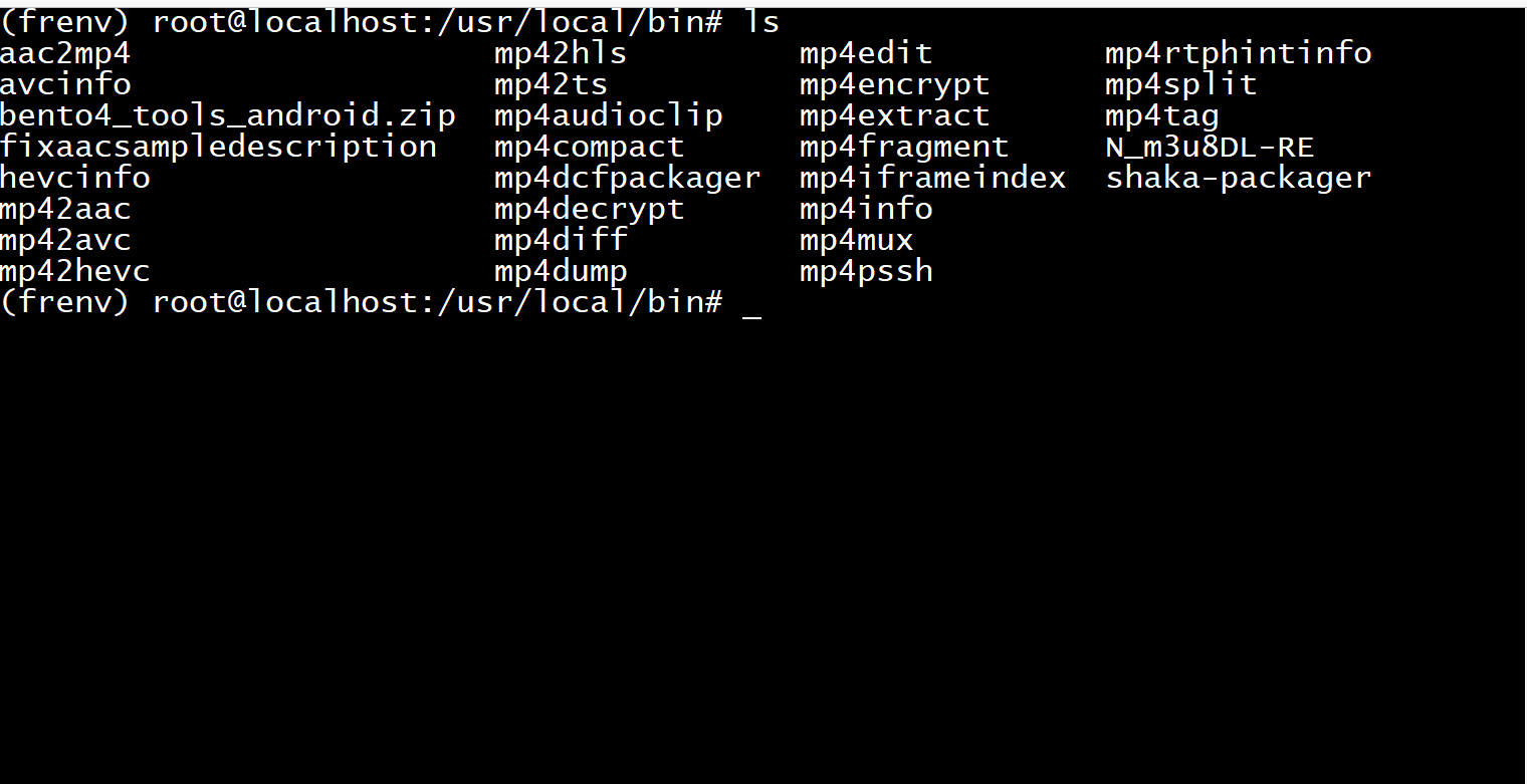

    Login to Linux distro in term
    proot-distro login ubuntu
    Next cd out of freevine env to root then into /usr/local/bin
    [Attachment 77524 - Click to enlarge]

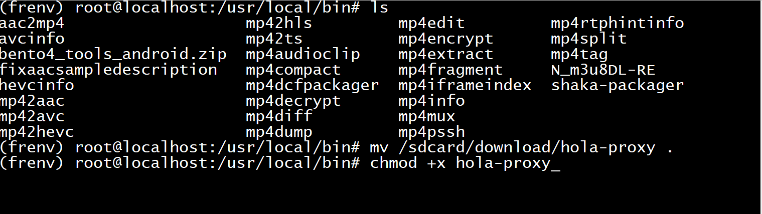

    mv /sdcard/hola-proxy .
    [Attachment 77525 - Click to enlarge]
    chmod +x hola-proxy
    [Attachment 77526 - Click to enlarge]

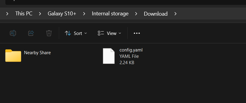

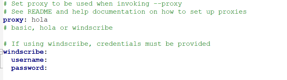

    cp config.yaml /sdcard/download/config.yaml
    This puts the config.yaml card in the download directory on your phone
    [Attachment 77527 - Click to enlarge]

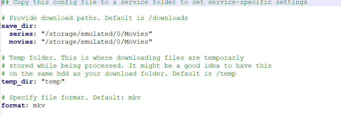

    Copy or move the files to your pc and edit I use Notepad ++ but normal notepad will do the job you can change 2 sections in the file
    [Attachment 77528 - Click to enlarge]
    Download location to Movies directory under internal storage so you can see if from your pc when connected via usb also you need to add the proxy line
    [Attachment 77529 - Click to enlarge]

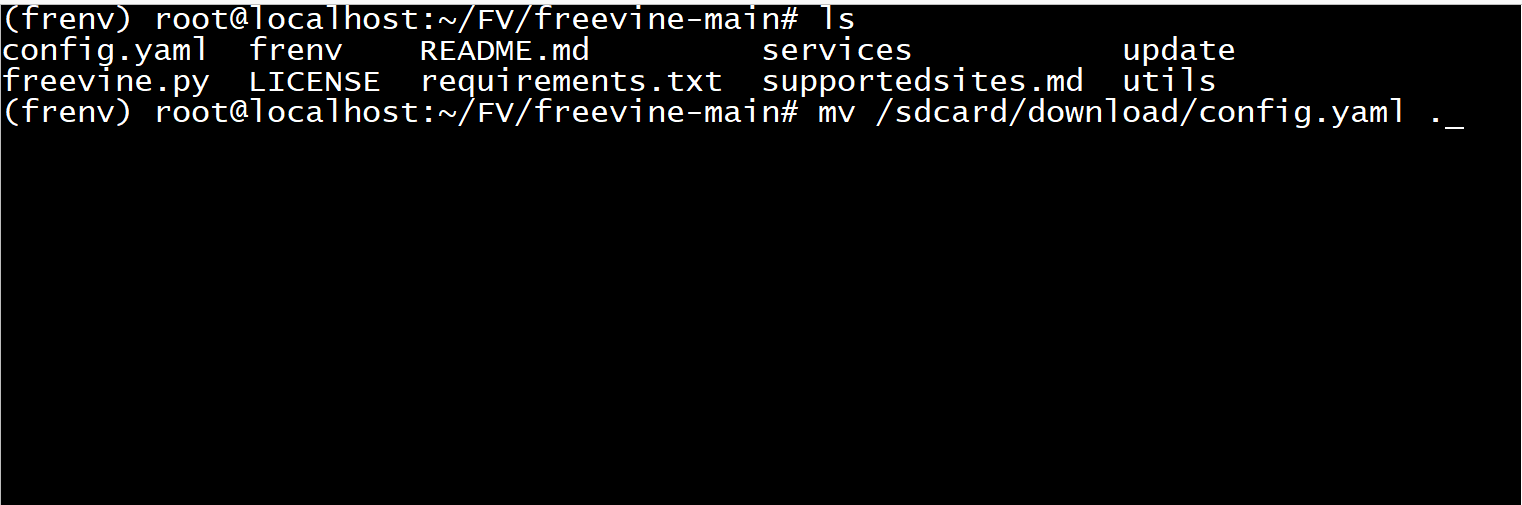

    Next copy your config.yaml file back to the download directory on your phone
    in your terminal window
    mv /sdcard/download/config.yaml .
    [Attachment 77530 - Click to enlarge]

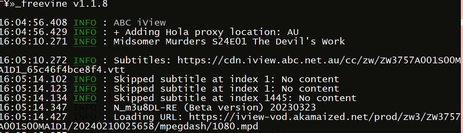

    You should now be able to test the proxy in freevine
    python3 freevine.py get -e https://iview.abc.net.au/video/ZW3757A001S00 --select-video res=720 --proxy au
    Either in your connected terminal or on the phone

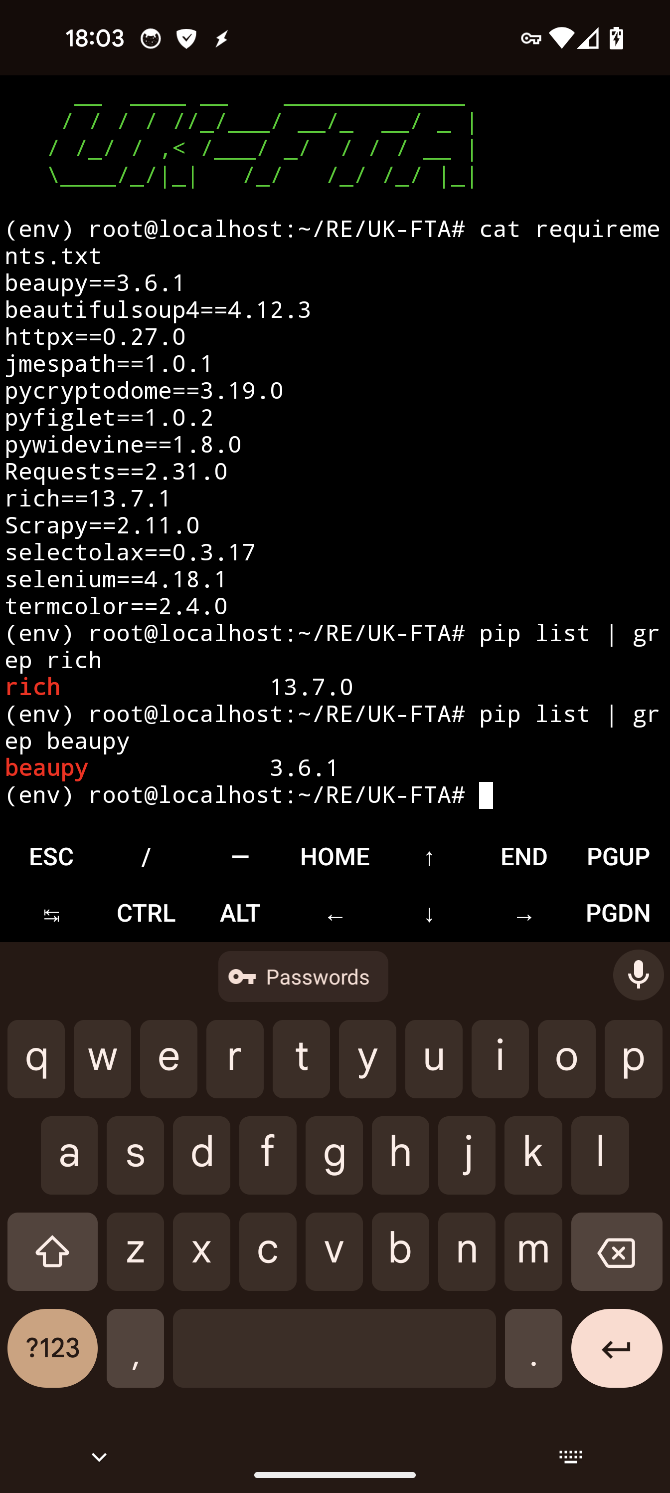

  18. i did freevine on 3 devices i get this with uk-fta
    RROR: Cannot install -r requirements.txt (line 1) and rich==13.7.1 because these package versions have conflicting dependencies.
    The conflict is caused by:
    The user requested rich==13.7.1
    beaupy 3.6.1 depends on rich<13.0.0 and >=12.2.0
    To fix this you could try to:
    1. loosen the range of package versions you've specified
    2. remove package versions to allow pip attempt to solve the dependency conflict
    ERROR: ResolutionImpossible: for help visit https://pip.pypa.io/en/latest/topics/dependency-resolution/#dealing-with-dependency-conflicts
    beaupy==3.6.1
    beautifulsoup4==4.12.3
    httpx==0.27.0
    jmespath==1.0.1
    pycryptodome==3.19.0
    pyfiglet==1.0.2
    pywidevine==1.8.0
    Requests==2.31.0
    rich==13.7.1
    Scrapy==2.11.0
    selectolax==0.3.17
    selenium==4.18.1
    termcolor==2.4.0
    Feb 2022
    Search the forum first!
    beaupy==3.6.1
    httpx==0.27.0
    jmespath==1.0.1
    pyfiglet==1.0.2
    pywidevine==1.8.0
    Requests==2.31.0
    rich==13.7.1
    Scrapy==2.11.0
    selectolax==0.3.17
    selenium==4.18.1
    termcolor==2.4.0
    bump beaupy to 3.7.1 or downgrade rich to 12.6.0. They all actually work together as is, it just their installation version limits giving trouble. And I have covered this before either here or in UK-FTA. I think there might be a -force switch for pip to to get the install to work.

  20. I've fixed it all now thank you. changed the requirements.txt and put it on another phone as well works brilliant.

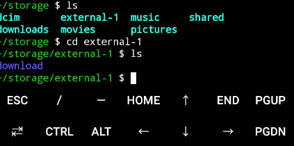

    [Attachment 79633 - Click to enlarge]
    Have put sd card in termux itself can see it but when you're in Linux it can't see it or I can't find a way to get it to do you create a link or something like that in android if nobody knows can they please let me know what forum et supports this please thank you.
