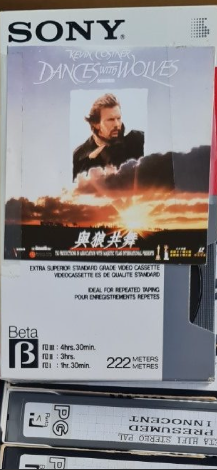

    The image of the Dances WW tape I am so curious about, which seemingly shows BIII at an incredible 4h 30m with 222 feet of tape - or does it?!

    I am interested in comments with regard to it please (e.g. if it's indeed only 222 feet how do they fit 4+hours on it?)
    All the other pictured tapes in the auction are L500, so I assumed the DWW tape was too?
    An L-750 is 750 ft, ~229 meters and can record up to ~4:45m in Pal / 4:30m in NTSC. The times listed on the box are for NTSC. Not sure about VHS, but all Beta tapes could record up to ~5 minutes more in βII. Almost useless trivia time. IMO, "B" when used to refer to Beta speeds is incorrect. It's β (for Beta) or Beta I, Beta II, Beta III.

    I just took a closer look at your picture and it's 1000% not an original. Not only is the tape not in a retail case, it has Chinese wording and the LaserDisc logo on the bottom. So it's very likely a copy from a Chinese LD.
