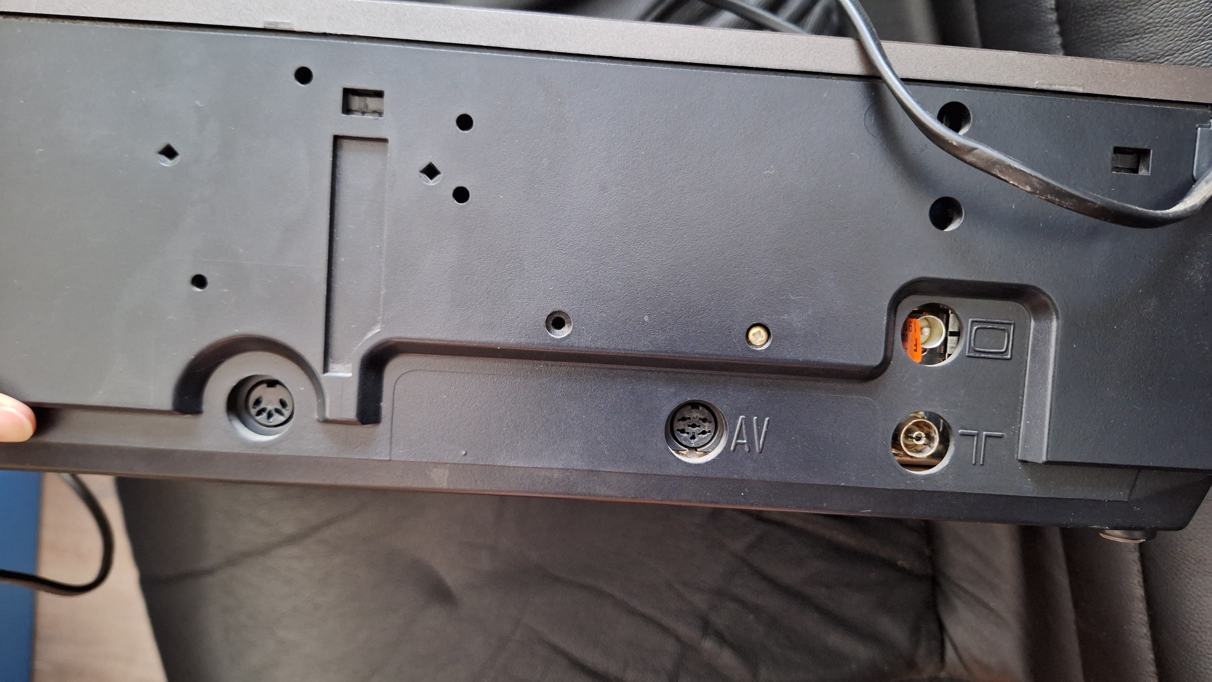

    i got some Video2000 tapes and a recorder from my uncle.
    He wants me to digitalise these tapes with private recordings.
    The recorder is a Loewe OC11M.
    It has only "antenna in" "antenna out" and two connections i dont know.
    [Attachment 74882 - Click to enlarge]
    He dont want to spend to much money in the project. Thats why DVD Recording is not an option for him.
    Is there a solution via USB grabber?

    See that connection port labelled "AV"? That stands for Audio-Video. That is the one you want to use. If you cannot procure a user manual or better, a service manual, you will have to figure out what each pin does. But it shouldn't be too hard: that era didn't have stereo videotapes, so audio-wise there should only be 2 pins used for that (signal & ground). The video signal is probably composite, not y-c or full component, especially if those tapes are not made in color, so that should also just be 2 pins (signal, ground). The hardest part is finding a plug that matches that style/shape, although you can get around that by opening the machine and tapping into the leads jus prior to the jack. If you do that for video & audio both, you should end up with 2 cables terminating in standard RCA plugs (with the "signal" of each in the central portion of the plug, and the ground in the circumference). It is unlikely, but possible, that both signals share a common ground.
  3. Member Cornucopia's Avatar
    Are you sure that is not an "antenna out" but rather "monitor out"? In which case, that actually might be the most straightforward connection point, at least for video. Looks like it could be a recessed RCA or BNC plug.
  4. You need a 6-pin DIN connector to Cinch. Then a grabber that has Cinch inputs. Most likely only the red or the white cable will deliver audio since that old recoder was for sure Mono and not Stereo. The yellow cable is for the video signal.
    https://www.adapterwelt.net/p/din-stecker-6-polig-auf-3-x-cinch-2-0-m
    Thank you, that is what i am looking for.
    This is pass trough connection - Antenna IN and TV OUT.

    If that is passthrough, then it is not the optimal one to use. Better to use baseband composite out (via the adapter) rather than RF.
  12. Cinch is the same as RCA but commonly used in Europe while RCA is used in the US. He should use the composite out coming from that DIN plug with the adaptor I linked. That Hauppauge part linked by Sharc is a potential converter that could be used but I have zero experience with it or any else from competitors. Everything that uses the HF data (antenna out) will decrease quality.
  13. Originally Posted by Cornucopia View Post
    Almost sure it is pass trough - it allows VCR to record aerial broadcast and watch on TV recorded material, also TV can use own tuner so you can record and watch at the same time two different channels - common configuration in those times.
    And yes, i agree - using CVBS is recommended - only adapter rated at 27 Euro is way too much in my opinion but this is somehow tricky DIN connector - i see it very first time - i blame German for this - normally you had or RCA or SCART (in VCR's after 1990) - DIN connectors was popular in 70/80's - this is probably because V2000 system - probably present only in part of Europe (mostly western).
