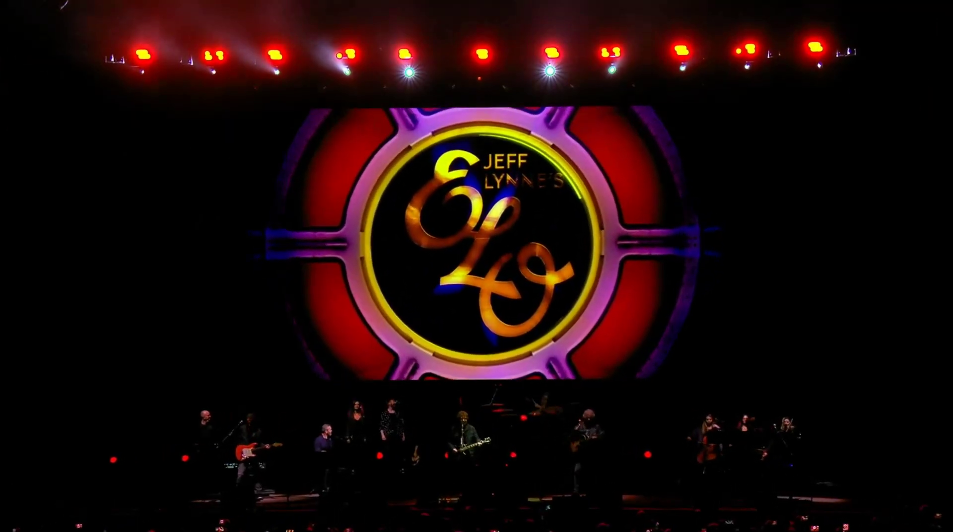

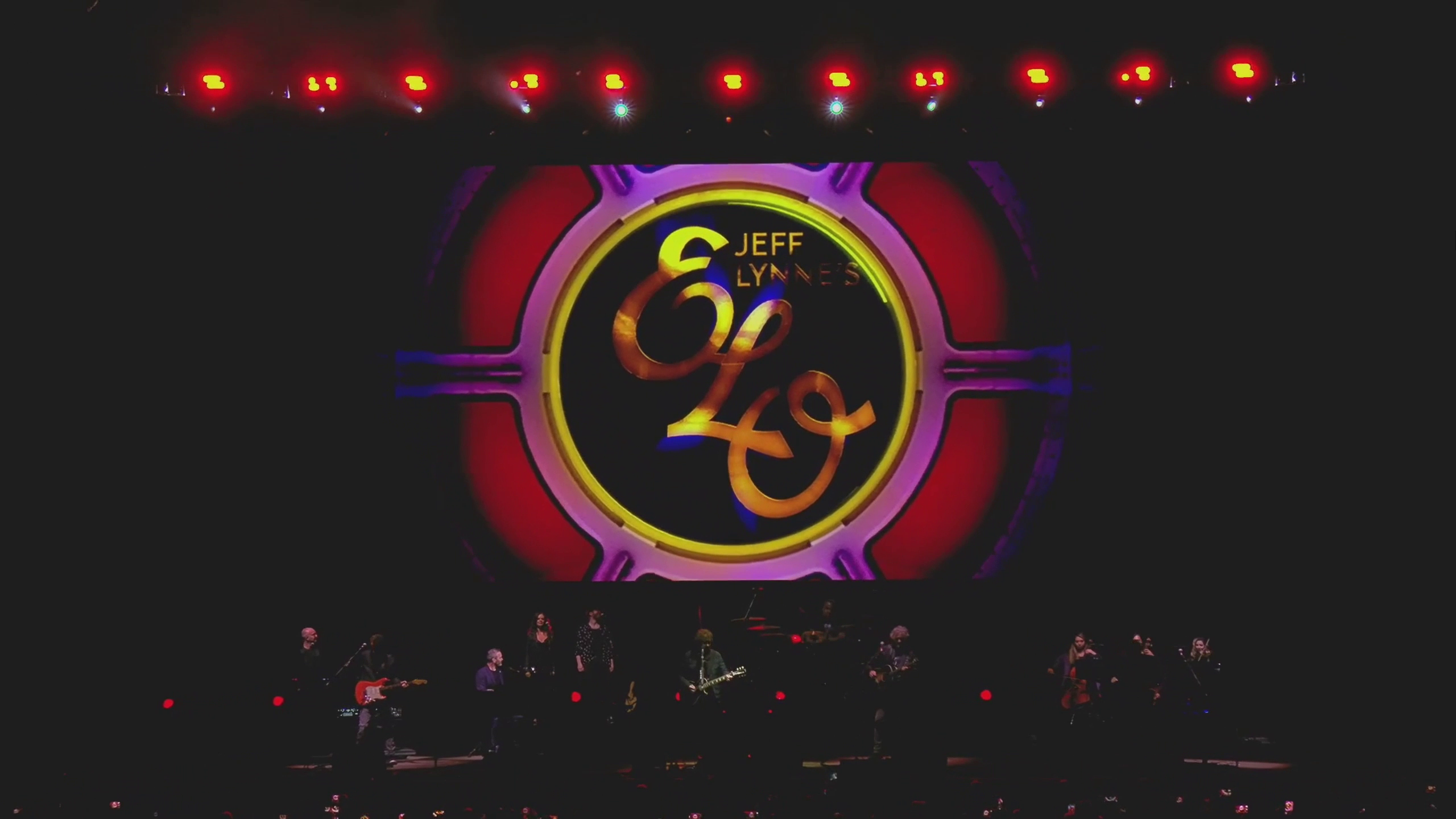

  1. As a big ELO fan the other night i pulled an all nighter and captured their first concert for 4 years on Vebut the blacks are horribly washed out. I downloaded a lower quality version from YouTube and the blacks are perfect, see screenshots.
    Is their anyway to correct the black levels of my larger file? It appears to be an issue with Game Bar.

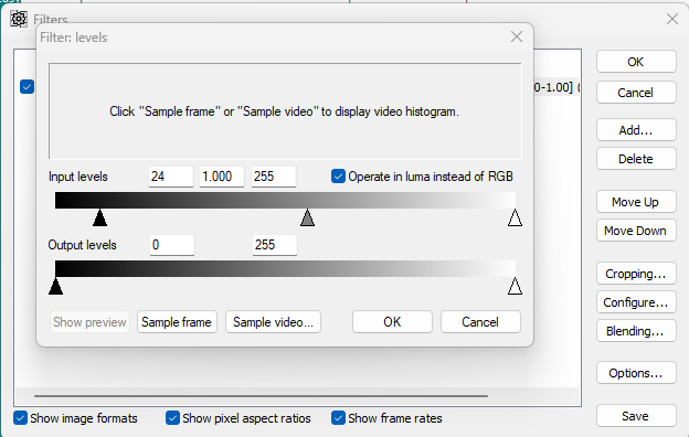

  5. How can i adjust the blacks in virtualdub?
  6. With the 'levels' filter.
    Something like this:
    [Attachment 75006 - Click to enlarge]
  7. Thanks, it actually works brilliantly using the brightness filter. The original file is an MP4 around 10GB in size.

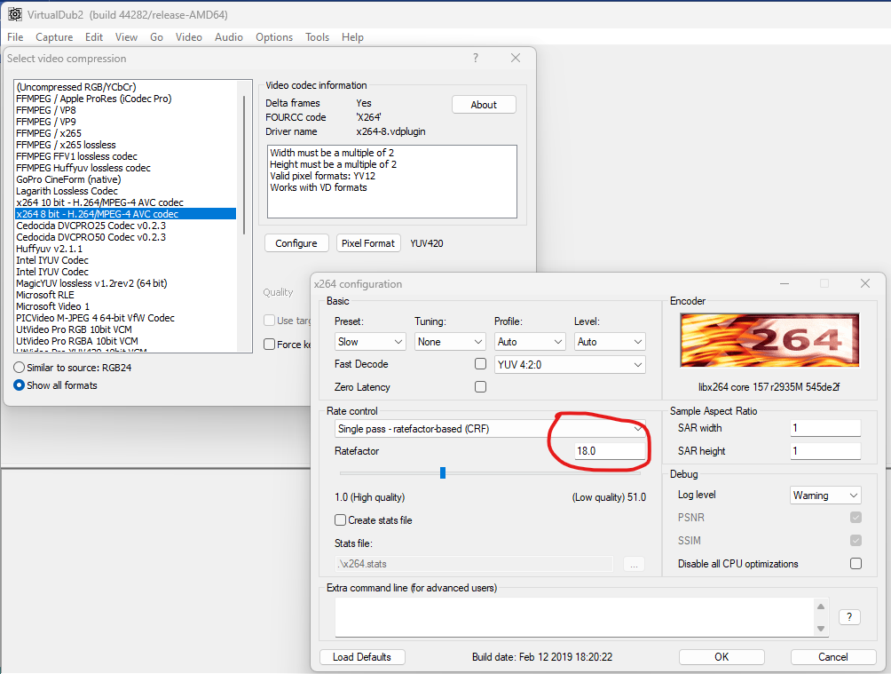

    vdub2 comes with x264 and can export MP4 . If you use CRF around 10-16 that's considered good quality . Lower values result in higher bitrates, larger files. QP 0 is lossless mode
    I would do a short test like 1 minute with one value like crf 16 or so to see if it meets your needs in terms of quality/compression trade off. You can mark in/mark out to export a selection. For audio, use audio=>direct stream copy so you don't degrade the audio
  10. Where do i adjust the CRF?
  11. Video -> Compression..... -> Select the codec (x264) -> Configure
