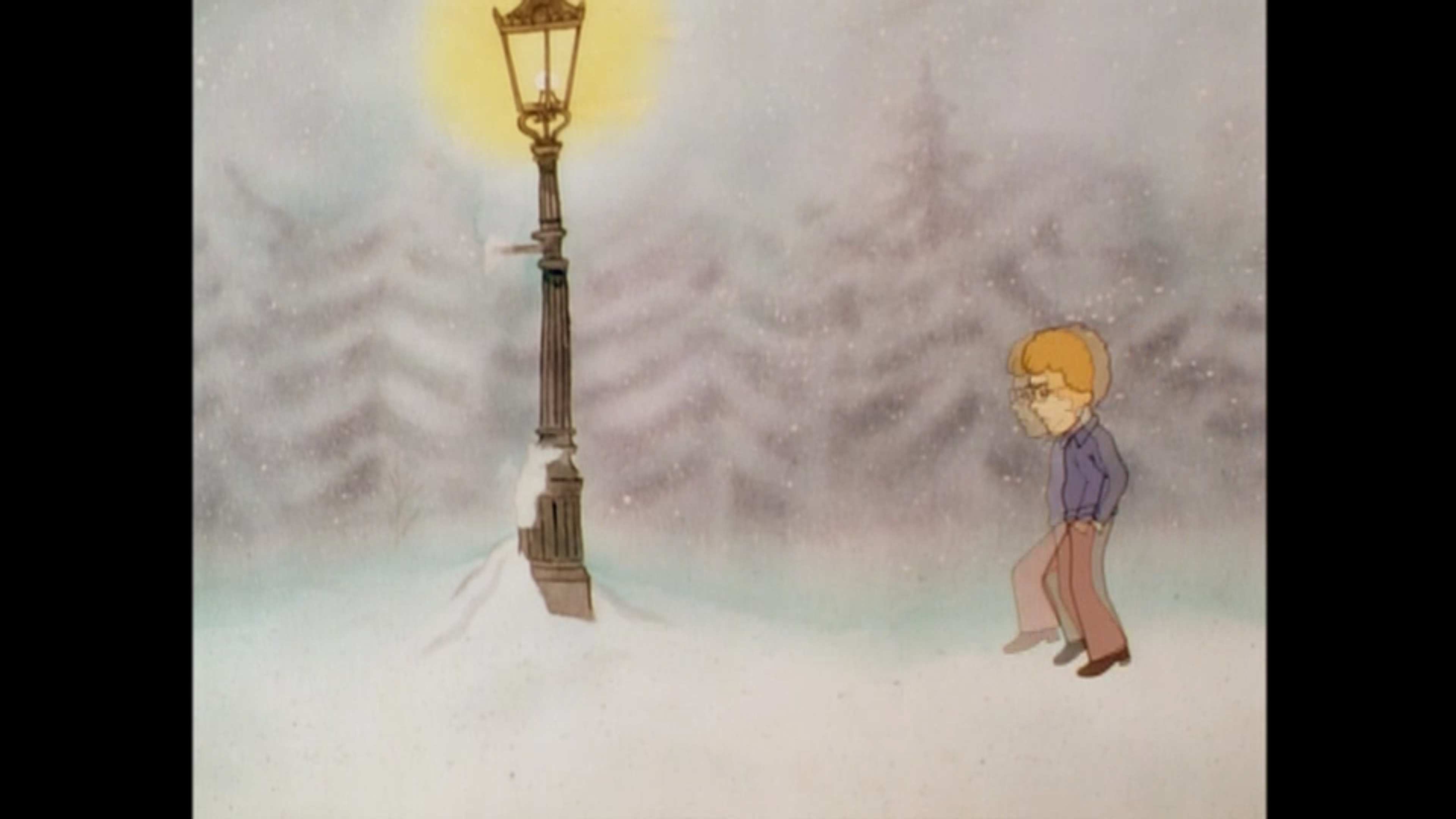

    I've been able to get to that point as well, but I'm still stuck with tons of blended frames. That's what I'm having a hard time getting rid of. See example frame.
    [Attachment 74864 - Click to enlarge]
    The studio did restore this cartoon in a later DVD release, and I'll post the same clip of how it should look for reference. The whole reason I'm trying to do this in the first place is because they cropped it to 16:9 for some reason.

    Your source has undergone a 25p conversion and field blended back to 29.97i . There are 3 continuous animation sections , around 9sec, 26sec, and the end. Those suggest your version is 25fps. You get jerky motion, dropped frames at 23.976 . Check the duration against published information on the original. I suspect this version is probably sped up from 23.976 => 25. If so, I would QTGMC+Srestore it to 25p and slow audio and video down back to 23.976
    You're still going to get some frames with blended line edge artifacts In some sections, when several consecutive field has artifacts, you cannot "restore" it, unless you use something more involved like photoshop, or heavy filtering (but that will soften image)
