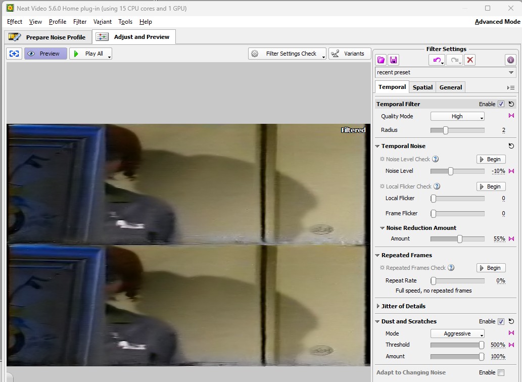

    Neat Video's attempt. Those white dots are only on single frames so I put "Dust and Scratches" on to "Aggressive" and maximum values.
  19. Originally Posted by Alwyn View Post
    One question, did you use NeatVideo on Avisynth? Because just this filter in Vegas doesn't remove these drizzles

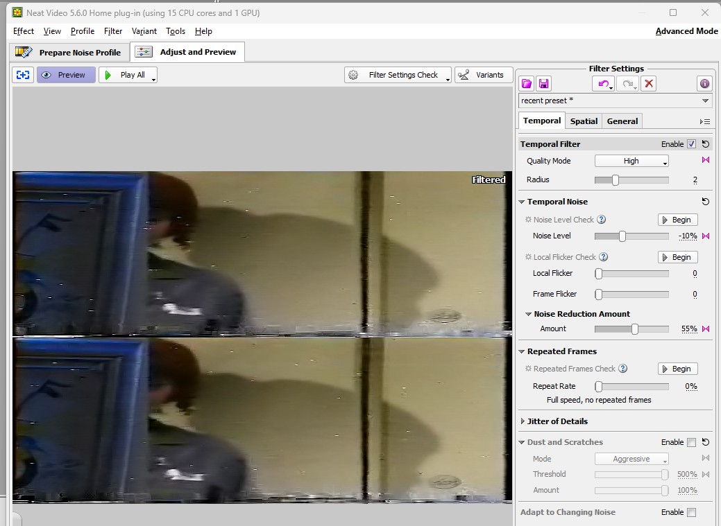

    Neat Video in VDub 2:
    Dust and Scratches disabled:
    [Attachment 74878 - Click to enlarge]
    Dust and Scratches enabled:
    [Attachment 74879 - Click to enlarge]
  21. Originally Posted by Alwyn View Post
    Very interesting, but is this plugin only paid? I downloaded a version that leaves a watermark on the video
