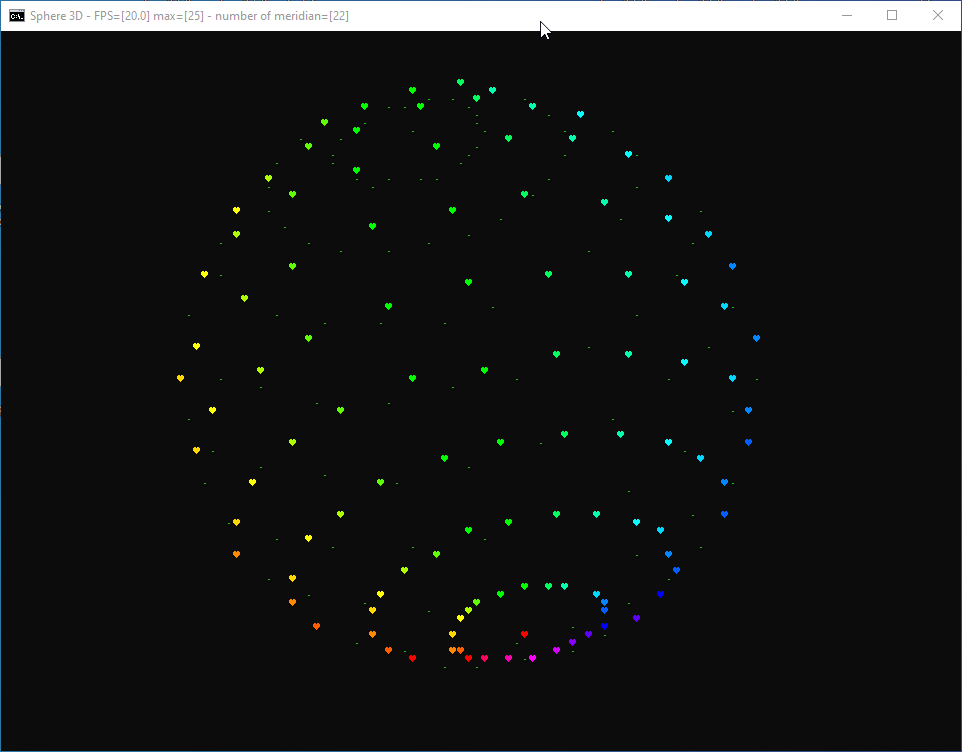

  15. Off Topics.
    I will definitely make it bulletproof. This is cmd batch done by me...
