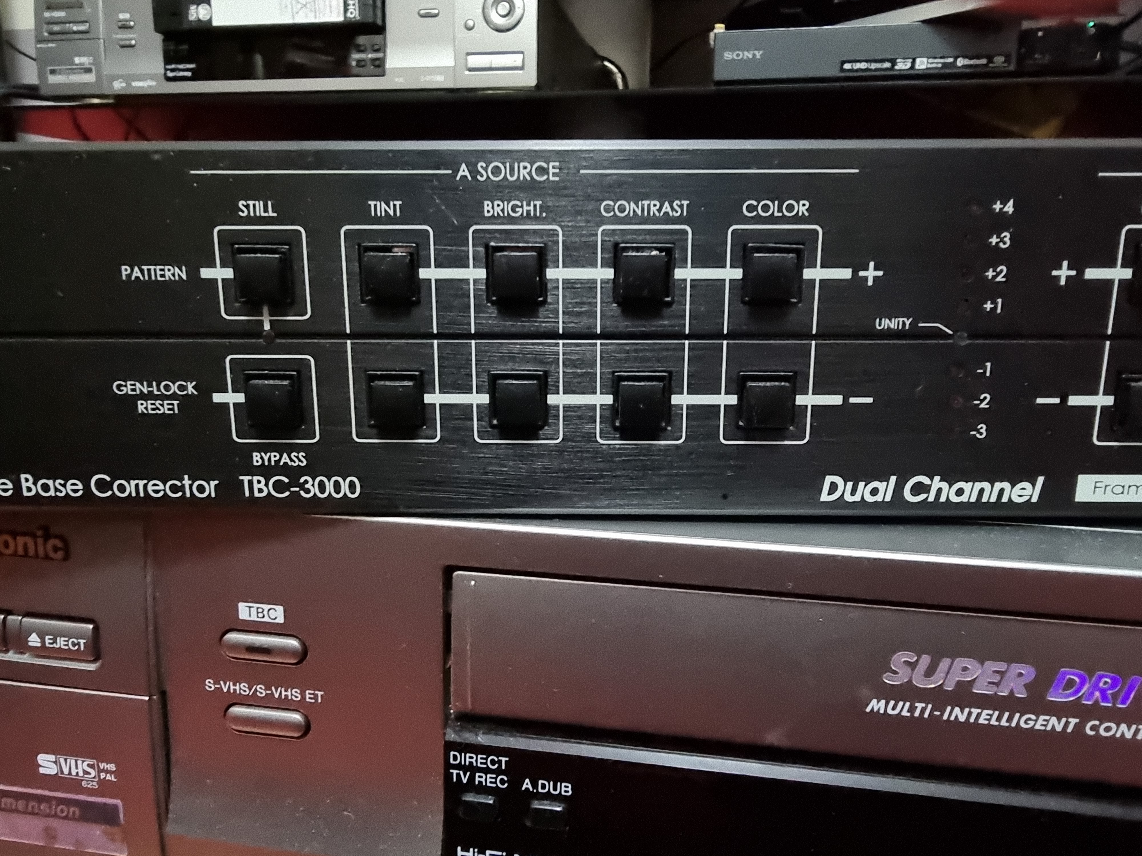

    Here's how my Proc-Amp looks from the front. Does Tint correspond to Gamma adjustment? And is Color just a Saturation setting?
    [Attachment 74753 - Click to enlarge]
    I can't help you with this proc-amp. But Tint is definitely not gamma. Tint changes the color tone (reddish - greenish - blueish ....). Color probably is the same as saturation.
    I would use the proc-amp settings of your capture device for adjusting the levels (via your capture software or via graphedit), or do everything in post processing.
