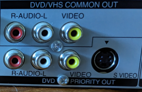

    I used the s-video out on the VHS/DVD player. Would using an alternate component out help instead?Image
