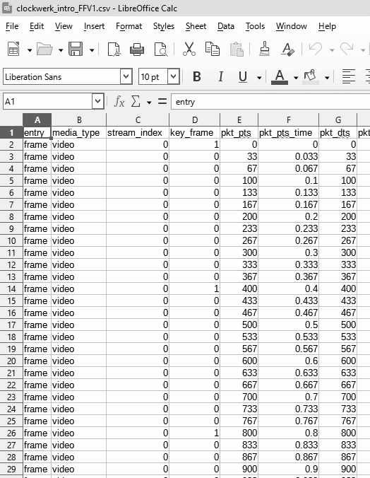

  28. Yes, ffprobe shows the keyframes. Here's the output of ffprobe in CSV (spreadsheet) format:
    [Attachment 74794 - Click to enlarge]
    You can see keyframes (columb D) at line 2, 14, 26, etc.
    The drag/drop batch file I used to get that:
    @set name=%1
    @echo entry,media_type,stream_index,key_frame,pkt_pts,pkt_pts_time,pkt_dts,pkt_dts_time,best_effort_timestamp,best_effort_timestamp_time,pkt_duration,pkt_duration_time,pkt_pos,pkt_size,width,height,pix_fmt,sample_aspect_ratio,pict_type,coded_picture_number,display_picture_number,interlaced_frame,top_field_first,repeat_pict,color_range,color_space,?,?,chroma_location > "%~n1.csv"
