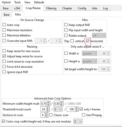

  2. "Crop/Resize->Misc->Misc->Flip->...."
  3. Originally Posted by Selur View Post
    Didn't work on 4K
  4. Works fine here on 4k content, here.
    read https://www.selur.de/support
    Try whether it works if you additionally enable Filtering->Vapoursynth->Misc->Script->Always use Vapoursynth.
    Cu Selur

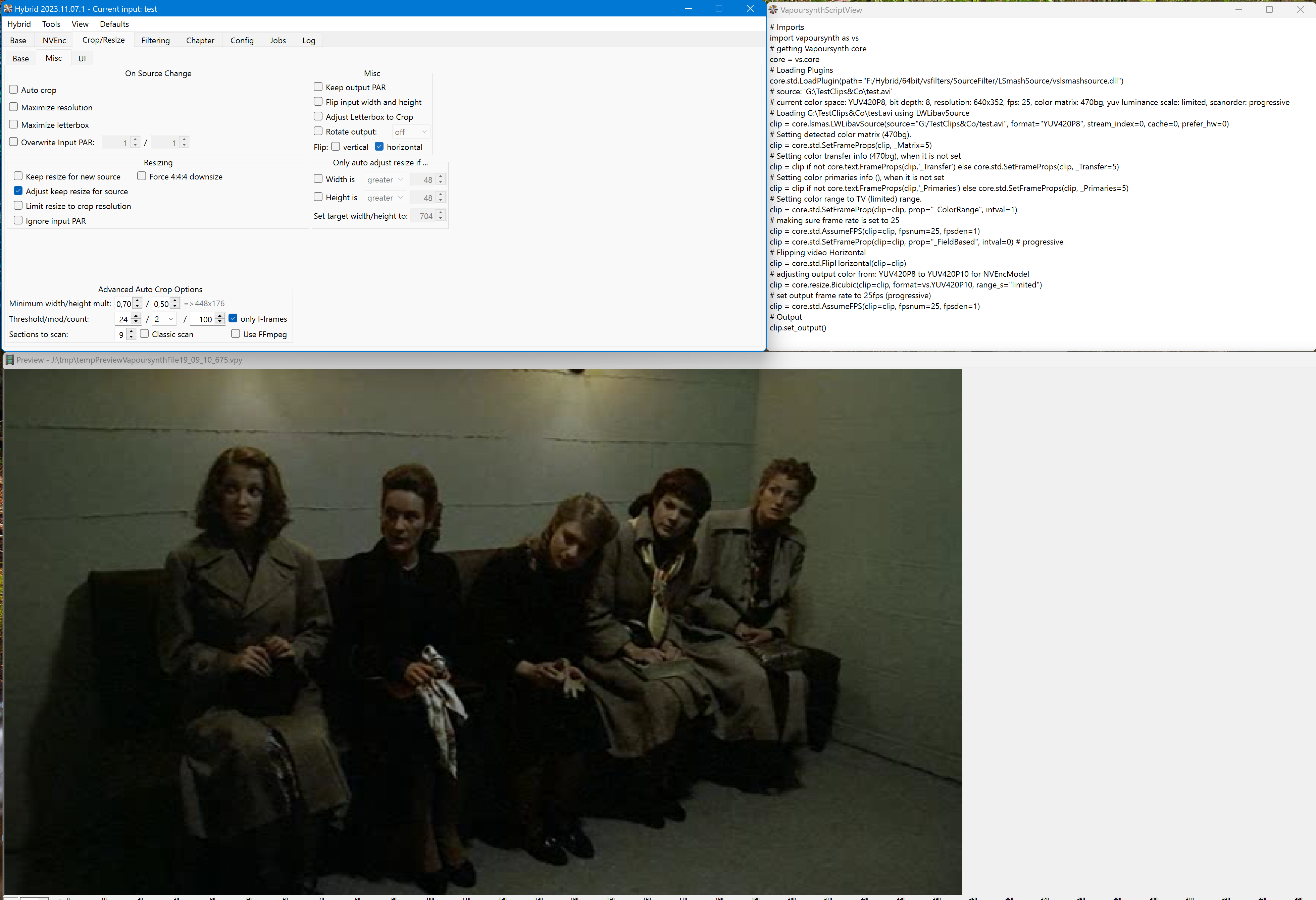

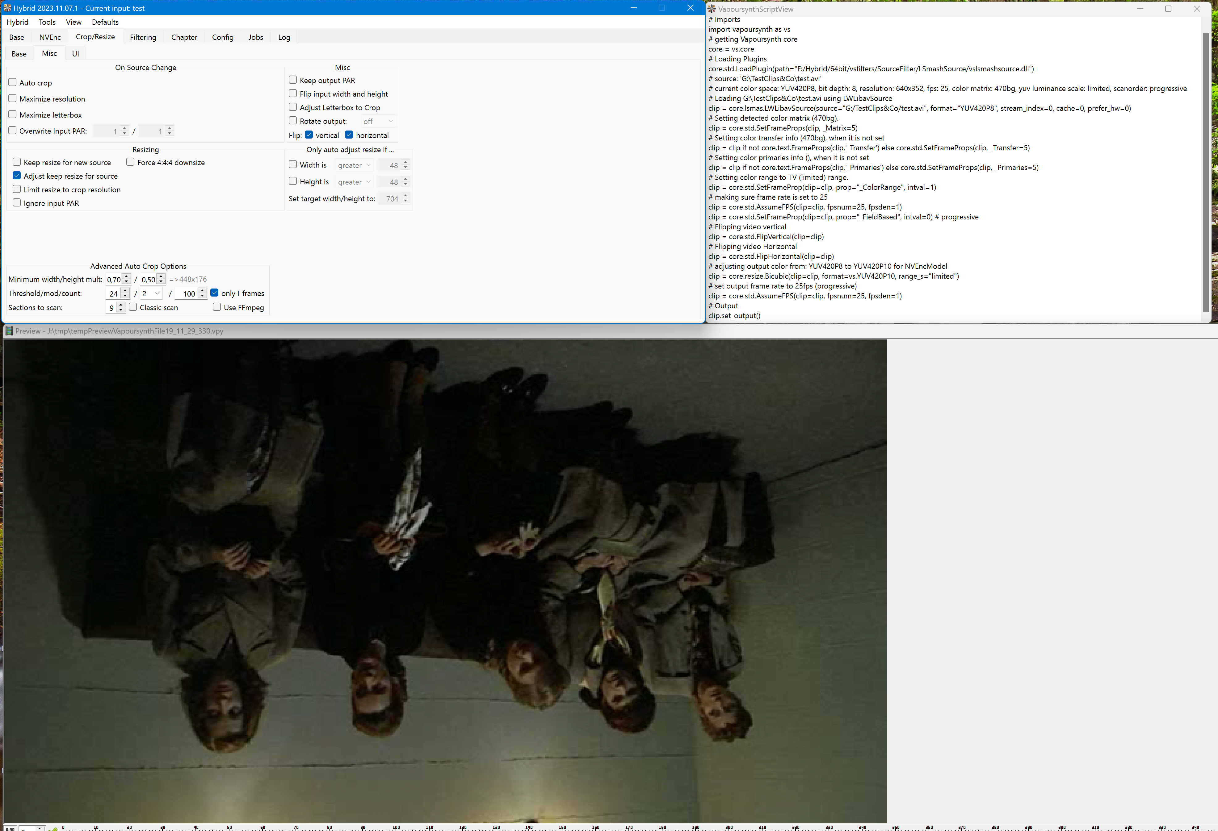

  6. Only vertical works
    But horizontal nothing on 4k
  7. Works fine here. (also works with 4k and 8k sources)
    If your input already has rotation info and the output container supports it, Hybrid by default will passthrough the rotation,...
    If this is the problem for you change 'Config->Container->General->Rotation handling' to 'ignore'.
    Since you clearly didn't read the support page or simply did ignore what was written there, I don't see how I could help further.
    Cu Selur

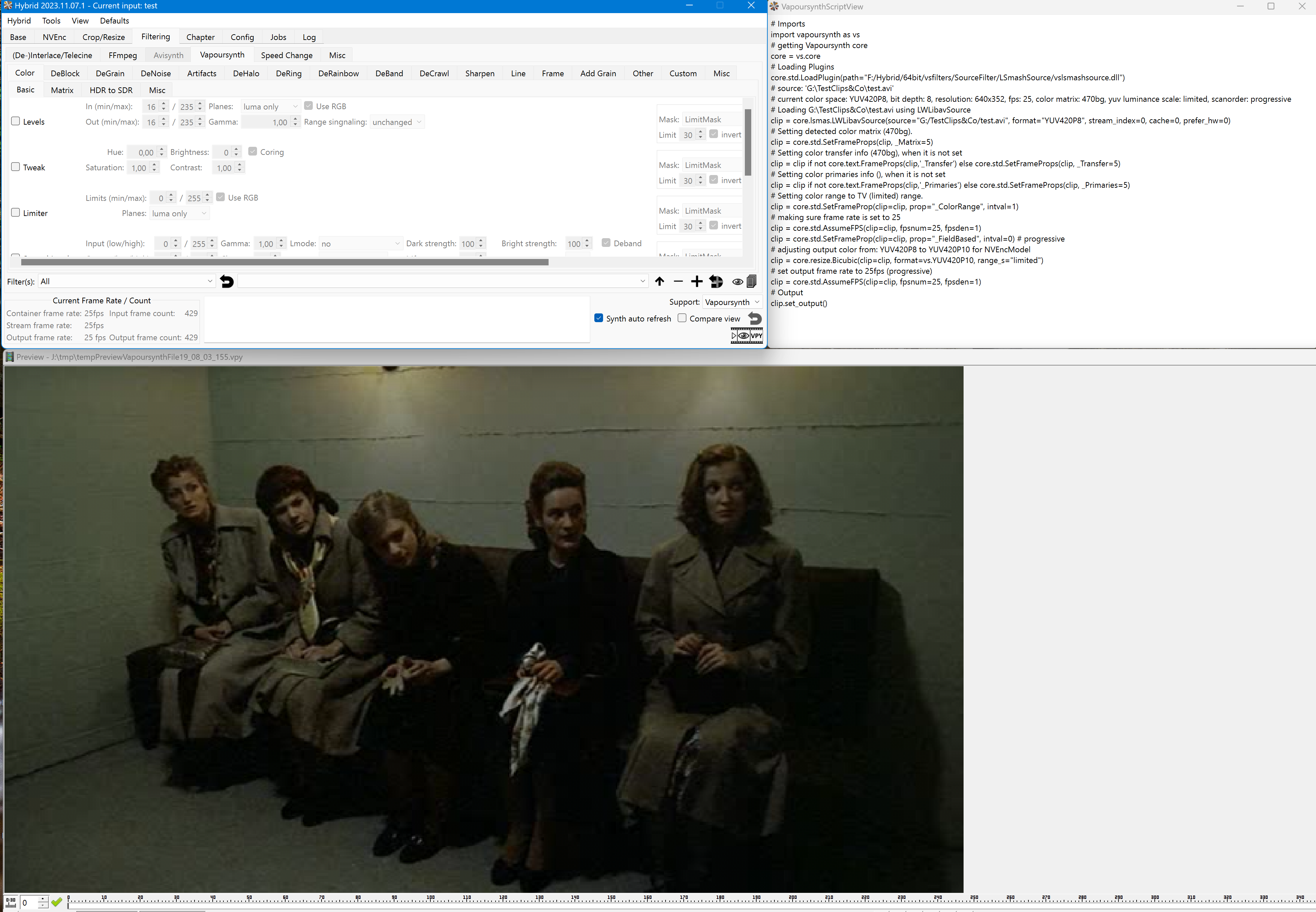

  8. Originally Posted by Selur View Post
    Cu Selur
    Please post a picture of this option

  10. Try whether it works if you additionally enable Filtering->Vapoursynth->Misc->Script->Always use Vapoursynth.
  11. Since you seem to be confident to solve this yourself, I'm confused what's unclear with:
    Cu Selur
