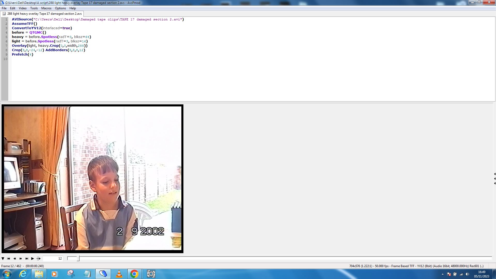

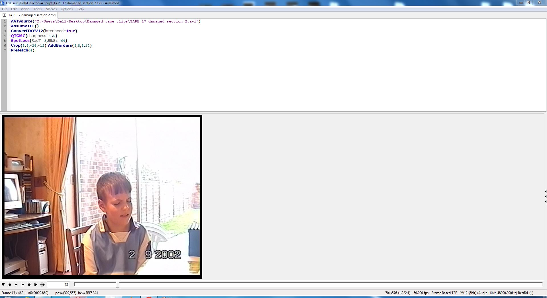

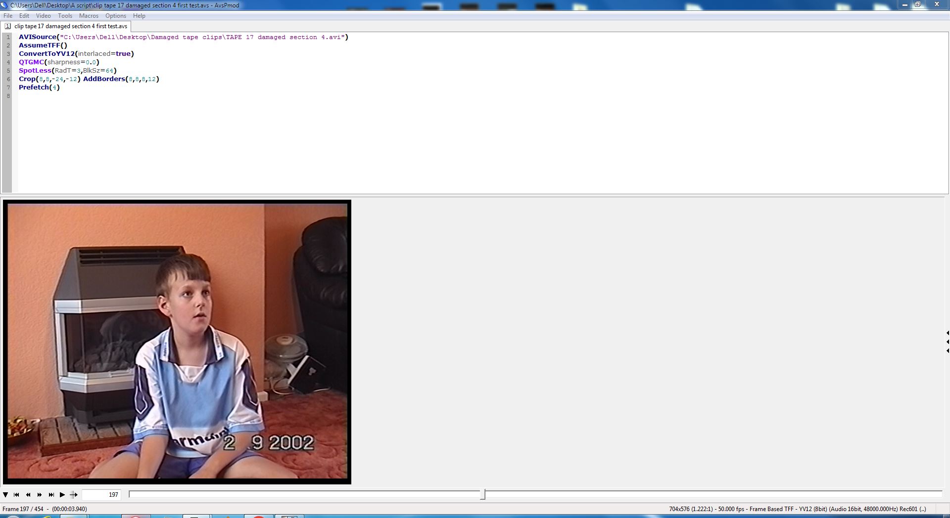

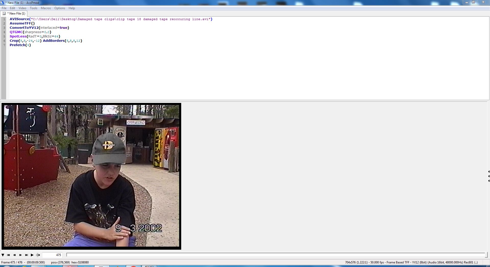

    Thanks Selur. That seems a really powerful tool, I didn't think anything would touch those lines. So far I have only used your values in the scripts and they seem to give great results. I've added my script snips just to check that my placement in the script of SpotLess is correct? I've added 3 new clips with the same damage and then after applying SpotLess.
    Is it better to divide the video and apply the SpotLess filter only to the damaged sections? Thanks.

  7. I've added my script snips just to check that my placement in the script of SpotLess is correct
    Placement seems okay to me
    (things are probably a bit faster if you place Spotless between crop and addBorders, sicne it would then run on a smaller image)
    Spotless will do some denoising, but as a side effect. If the settings cause problems in other scenes, only running Spotless on a restricted range can help, if it does not splitting the source into xy sections would be too much trouble for my liking.

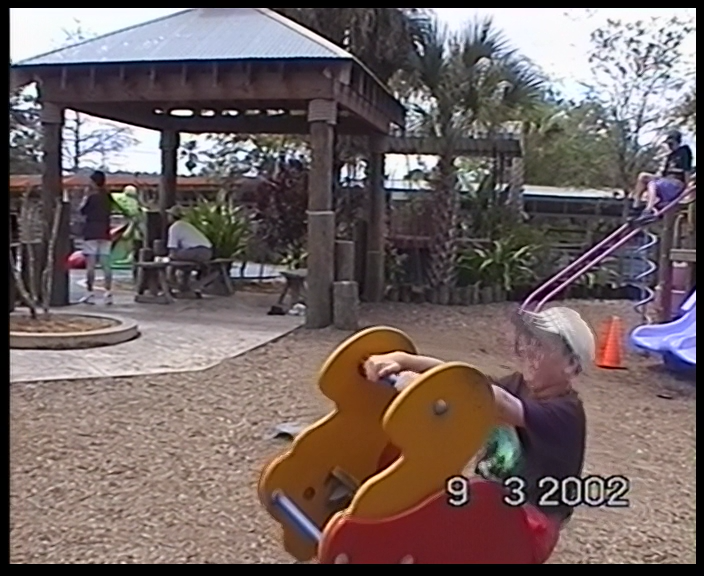

    Thanks Selur & jagabo. I've put the SpotLess between crop & add borders. I've lowered the blksz to 8. I'm guessing I need to play with the values without creating too much distortion?
Name:	clip 18 new placement BlkSz=8.JPG
  11. Those spotless settings are causing pretty significant damage to moving portions of the picture.
    That's what I suspected.
    Yes, try adjusting the temporal radius (should be <=3 and the block size, I suspect 16 might be okay)

    I've uploaded the clip using BlkSz=16 which looks good also without having the damage on his cap. I will divide the videos as I believe this problem was on the end parts on two of my tapes. I will do a few tests and see if I need to reduce the values when there is more movement.

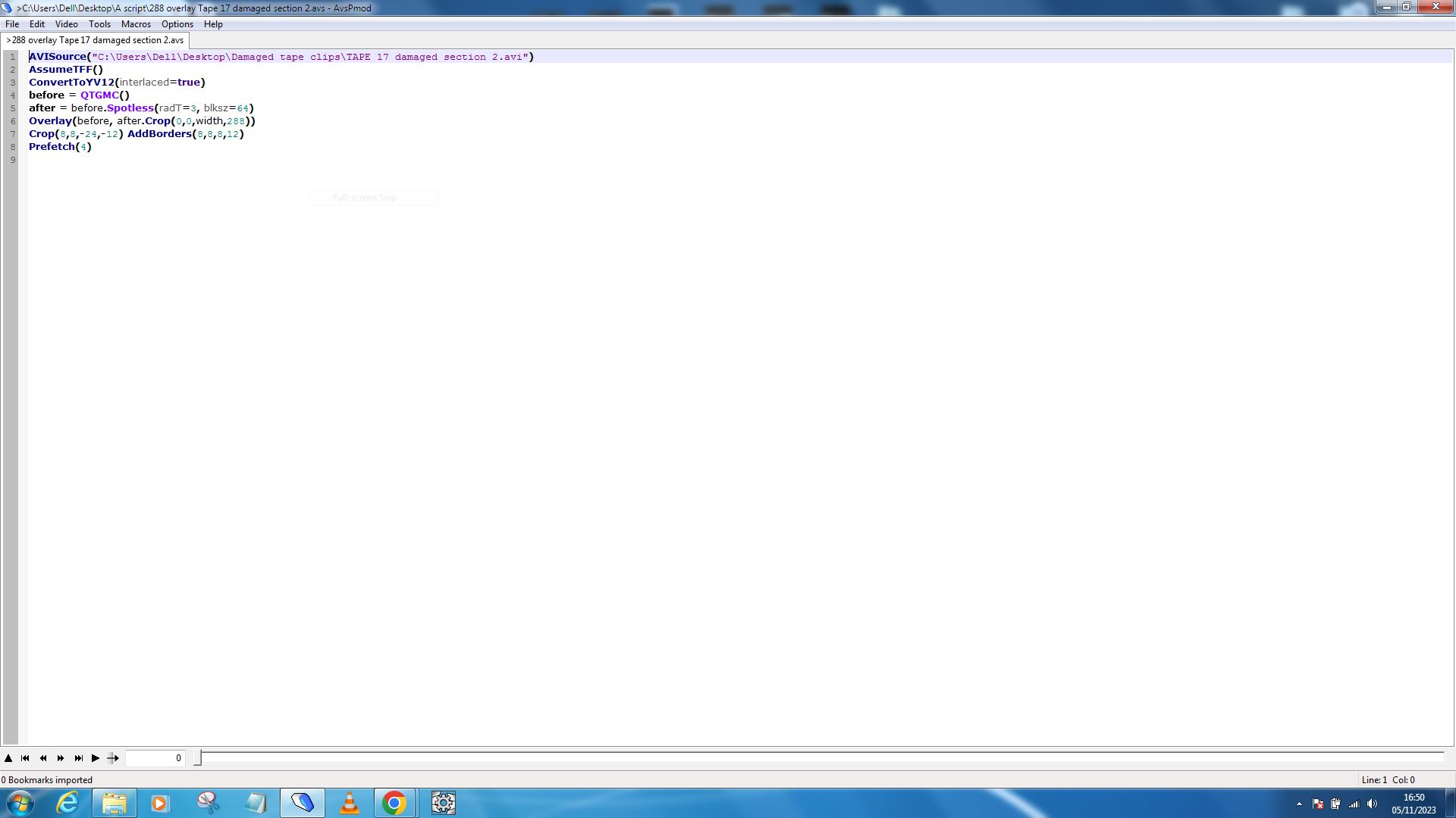

  16. Originally Posted by SkyBlues2021 View Post
    Thanks jagabo. I've added your script to the clip and probably made a mess of it. I wasn't sure if my placement is correct? Thanks.
    Looks right to me. Note that the Spotless settings don't remove all of the errors. Given that there's not much motion at the top of the frame you could go back to using blksz=64 to fix more of the errors.
    Sep 2021
    Thanks jagabo. I thought that the blksz=64 seemed to work well on #6 post (Tape 17 damaged section 2) as there was little motion, just my son sitting. Do you think it's best to use the script you gave me post in #14 on this, replacing blksz=16 with blksz=64 as there is little motion?
    I think on Tape 17 damaged section 2 the error seems to come down lower so should I use 288 as my value? I've uploaded the 144 line script & mp4.
    Overlay(before, after.Crop(0,0,width,288))
    Thanks.
  18. Originally Posted by SkyBlues2021 View Post
    That's probably ok with that clip.
    I don't think I have that clip. But yes, you can do that to cover more of the damage. Another possibility is to use heavy filter for the top part of the frame and lighter filter for the rest:
    before = QTGMC()
    heavy = before.Spotless(radT=3, blksz=64)
    light = before.Spotless(radT=3, blksz=16)
    Overlay(light, heavy.Crop(0,0,width,288))
    Generally, use the lowest value of radT that gives the desired result.
    Sep 2021
    Thanks jagabo. I've uploaded the original damaged clip. The 288 lines script and mp4 and also the 288 lines heavy light script and mp4. Both look so much better than the original. Which do you think is the better of the two to use? I can't believe that you could get such good results with such a poor clip. Thank you.
