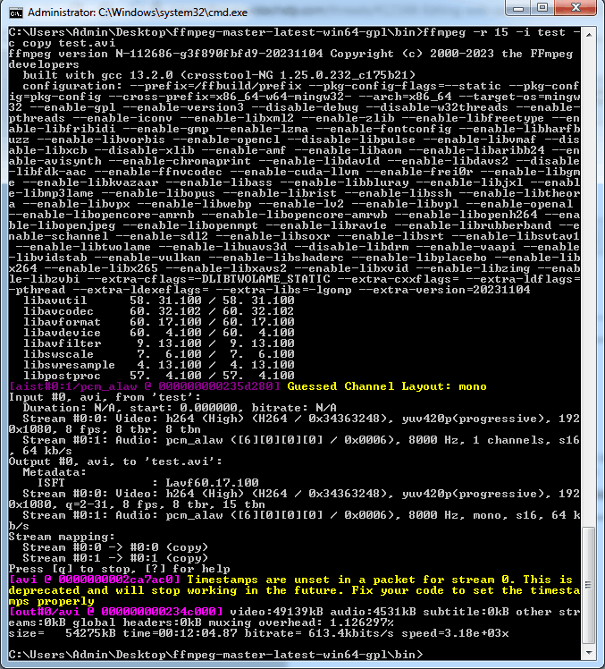

  10. Ok. On the test files (some even work), but on the ones I want to convert I get this error:
    I enter 15 fps, but it copies it as 10 fps and I can see that the video is slowed down.

  11. Originally Posted by jebaniec View Post
    As i said in post #8 you must use - r 8 on this video.
  12. But when I enter:
    ffmpeg -r 8 -i test -c copy test.avi
    then the film won't be slowed down even more? I want to increase the amount of fps
    Edit: Even I put this command I have the same lenght of video. :[
    ffmpeg -r 15 -i baby.avi -c copy baby15.avi ant still have the same lenght, as -r 8 (or without -r parameter)
    I attach file baby file
  13. Originally Posted by jebaniec View Post
    But when I enter:
    The command line according to post #6 is only there to generate the missing timestamps and thus make the video readable by editors.
    It is not there to change the framerate.
    If you want to do that, load your corrected video into an editor and recode it with the desired fps.
    However, the quality will not improve.
