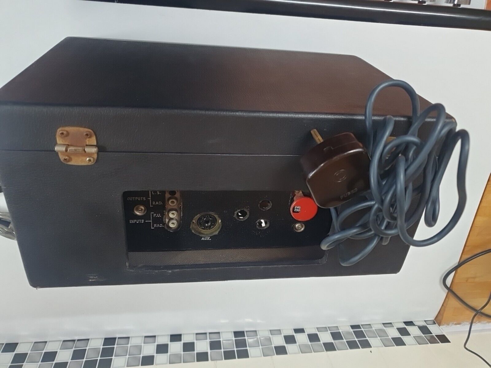

the reel to reel tape recorder is a ferguson serial number 7856 on the back of this machine it says this
it also has some ports at the back of this machine it has inputs P.U. and RAD.
and outputs L.S. AND RAD. so my question is can i play the reel to reel tape and record it to a dvd disc through my dvd recorder

Here is a link to all Ferguson tape recorders, Picking one and looking at the back it looks like in the photo below, So it uses DIN connectors, a DIN breakout is widely available online and the only socket useful is probably Radio out, Speakers left and right can be used with an attenuator:

delsam34 hi my ferguson reel to reel tape recorder does not look like the one you shown a picture of my one has the inputs and outputs of PU. AND RAD PORTS but they look like rca ports not thoses ports what you show a picture of.
if i can get maybe some kind of cable or adapter. i could play the reel to reel tape cos the machine is fully working just a bit dusty thats all. and could i record the audio onto a cd or dvd disc with the dvd recorder can i do that way cos i dont have a computer. and i dont think you can do it through a phone like victoriabears said.
also i dont know what type of cable is a PU. cable or a RAD. cable and i dont know where to buy them from
i was thinking if i could get thoses ports PU. and RAD. with some type of cable to the ports on the back of the dvd recorder but i dont know of any cables that will do that. it is only the audio i need from the reel to reel and record onto a dvd or cd disc with the dvd recorder. i dont really want to use a hi fi or speakers system connected to the reel to reel tape recorder like victoriabears said.
also i dont have no hi fi or speakers system.
the ports are just like this one on ebay
Ferguson 3218 Reel To Reel Tape Player Recorder my one is the same as this one it looks like kind of rca ports at the back but it is not it looks like that. and delsam34 picture looks like kind of s-video ports but it is not
[Attachment 74598 - Click to enlarge]Last edited by barry25; 29th Oct 2023 at 08:46.
You don't need any special cable, just a regular RCA cable that you can still get in a brick and mortar store, However your machine is mono so you would need a mono to stereo RCA splitter, If you can buy online get this, if not have someone with access to buying online get it for you.
Connect the splitter to the back of the machine Radio out, then connect the RCA cable to the two RCA sockets, connect the other end of the RCA cable to the input of your DVD recorder, put a blank CD and record a CD audio, If your DVD recorder is not capable of recording CD audio you will have to make a DVD video using blank DVD discs and just listen to the audio. They do sell audio recorders that record sound from an audio output without computer, depends on the budget from very cheap Chinese crap to high end ones for few hundred dollars. -
